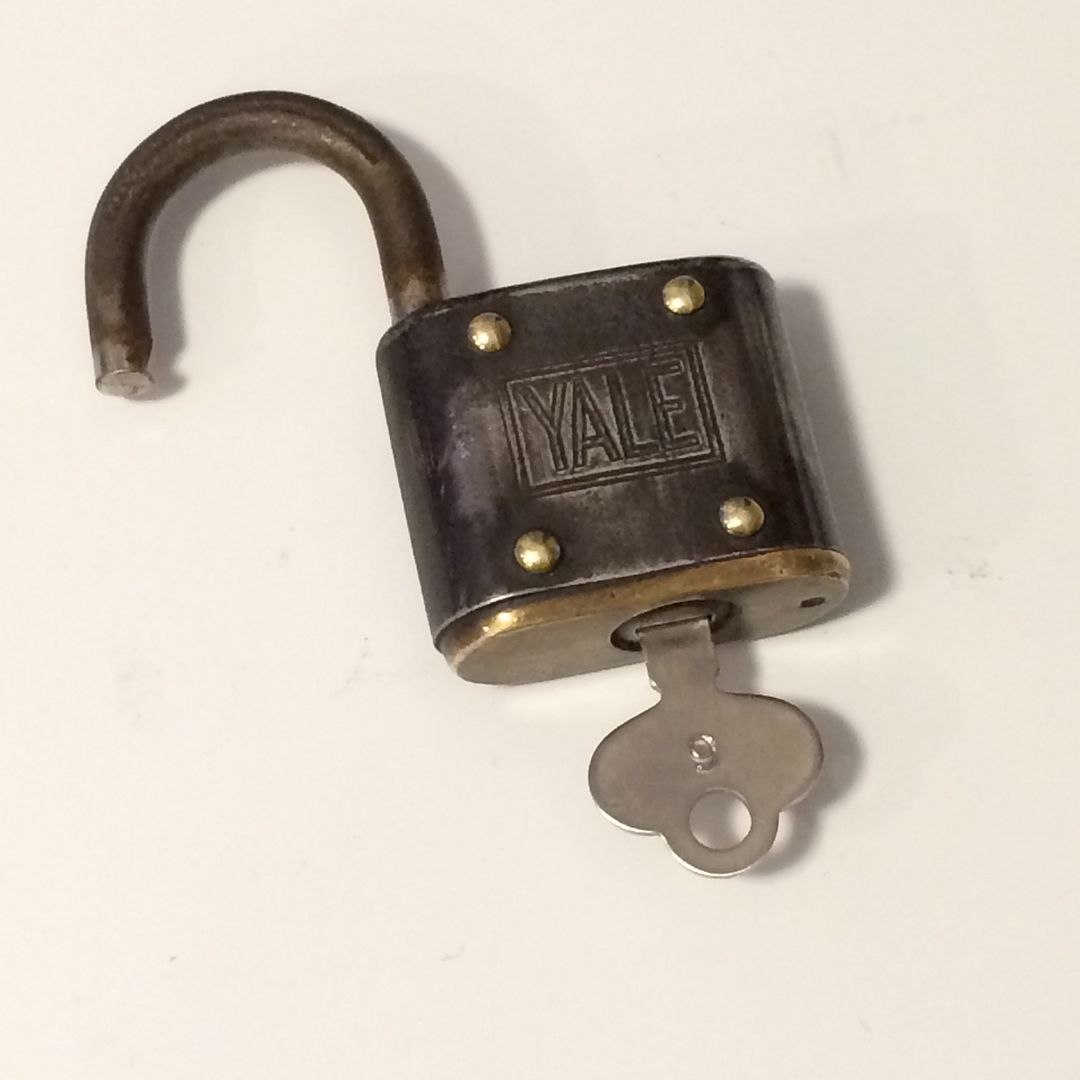

Had two Yale 563 black iron padlocks laying around for awhile. Finally hit up my local locksmith on the off chance they carried the obsolete blanks these take, and got lucky (I needed two, they had three in storage).
These are three lever padlocks with a single ward in the throat area. One down, and one to go!

Postby Silverado » 13 Sep 2016 17:57
Very cool. That's a really nice looking lock too!

Re: What Did You Impression Today?
Postby mseifert » 13 Sep 2016 18:25
Nice Work Robot

Postby Robotnik » 13 Sep 2016 21:02
Appreciate it. Hopefully my luck holds in impressioning this one's twin.

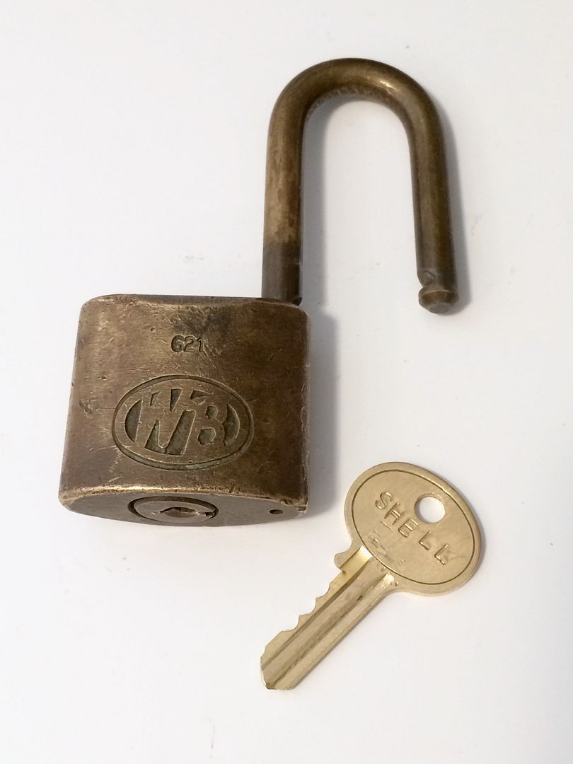

Impressioned this Shell Oil Wilson-Bohannan 5-pin today. It was acting pretty squirrelly - marks were erratic, and the lock went into something like a deep false set for the last third - so I was surprised when the plug turned.

Postby mseifert » 14 Sep 2016 20:36
Another nice job.. Makes me want to break out my WB and attempt an impression

Postby Robotnik » 14 Sep 2016 23:08
mseifert wrote:Another nice job.. Makes me want to break out my WB and attempt an impression
Have fun! I've had good success with 621s, but 620s with their tighter spacing have been maddeningly difficult for me.

Postby jeffmoss26 » 15 Sep 2016 7:28
beautiful WB!

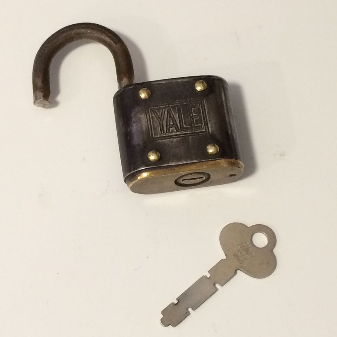

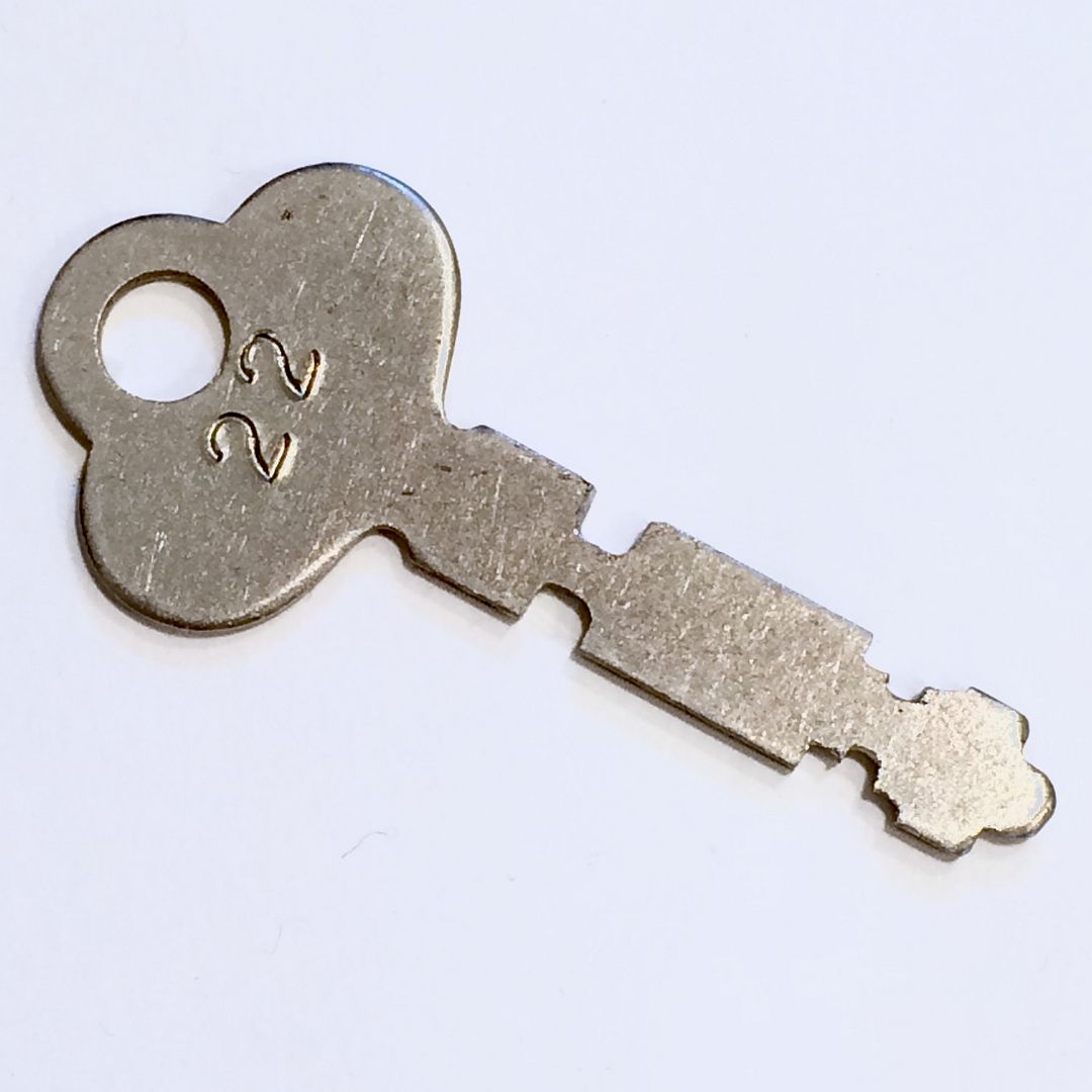

Managed to open the (uglier) twin to my previous Yale 563. As mentioned before, these are three lever, and the cuts can be duped into the opposing side to make the key bi-directional.
