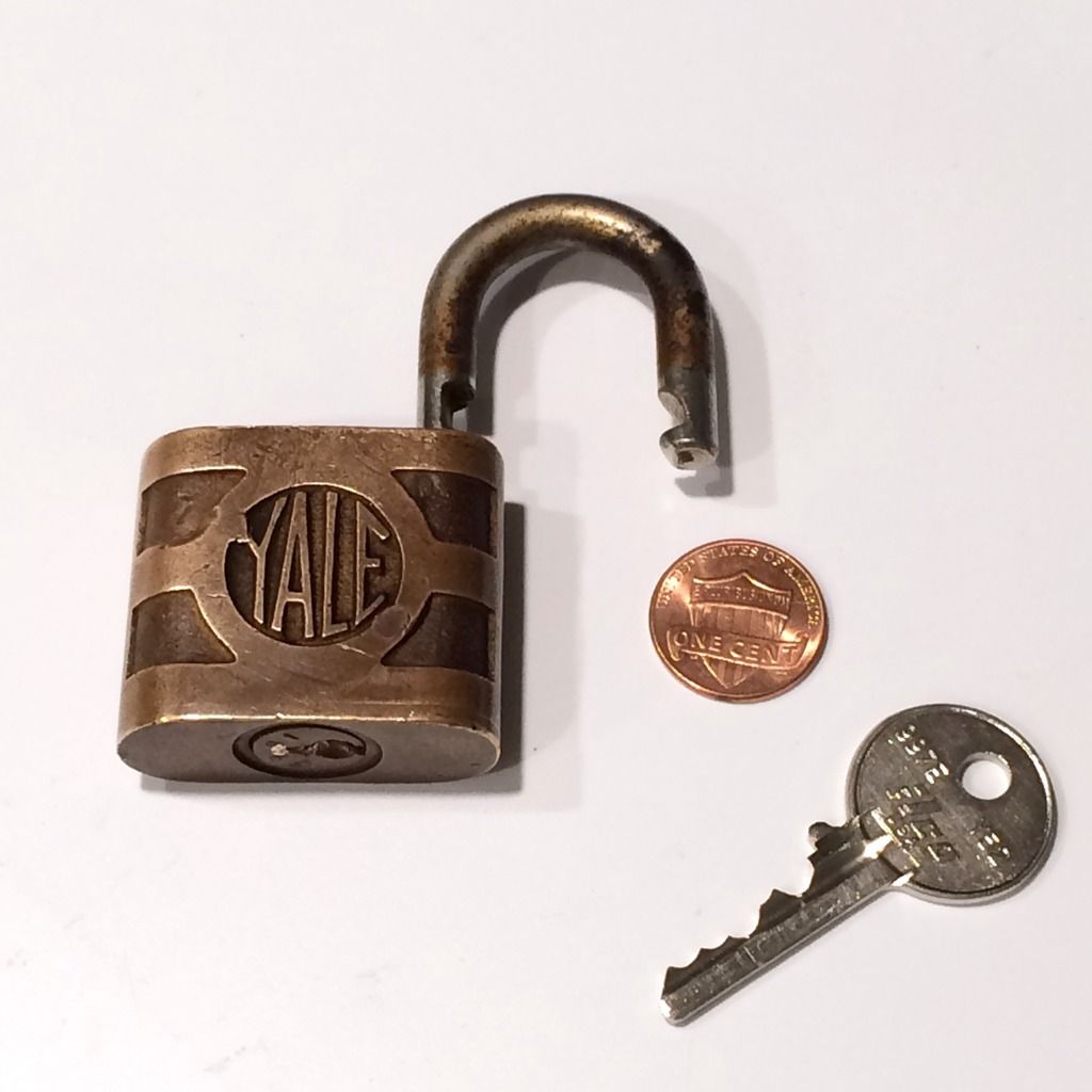

Impressioning warded, lever, and wafer tumbler locks has always come relatively easy to me, but I've been lost when it comes to pin-tumbler. Been working on my file technique, watching videos, upgrading workstation lighting, all that...finally paid off
Successfully impressioned this mini (1.25") Yale padlock I've attempted in the past. Blind code was no help (cut a 52644 key based off code, ended up being 85977...the last two depths were between 7 and 8, though).
For the first time, felt like I knew what I was looking at and how to interpret the marks I was seeing. A good feeling, for sure.

Nice job! Very cool :).
I love these old Yales

Very nice work. The twisty Yale keyways can be tricky. :)

very nice, love those old Yales.
