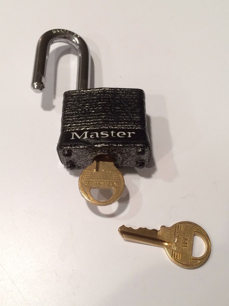

Master M3. Felt the key blank breaking, so I stopped and started over with a fresh one. Once I finally opened it, I found I was literally two file swipes away from success on the first key :)
After impressioning the 1.25" Yale from a previous thread, and failing at impressioning a Corbin master ring, this was refreshingly simple.

Master No. 3 is the model of the above lock...despite what my autocorrect thinks :)

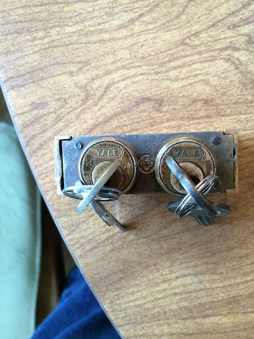

Guard key for a Yale safe deposit box with peanut cylinders.

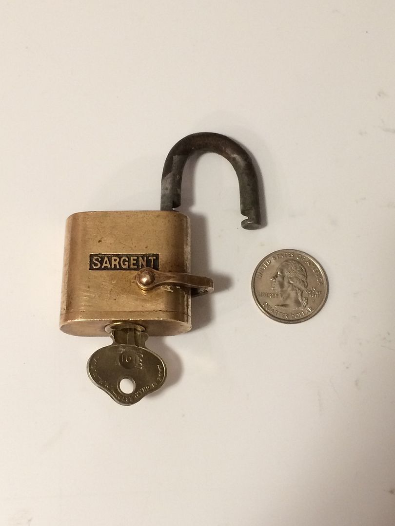

Impressioned a "mini" Sargent padlock with an S10 keyway. I purchased a random collection of ~200 vintage key blanks yesterday, and to my delight, it included three of these (relatively uncommon) blanks. First attempt failed, but this second attempt today was successful. The zero cut in the third position tanked my first attempt early on; even filing in pin spacing after the first pass took too much material off.
Photographed next to a US quarter and a full-size Sargent for reference in the second pic.

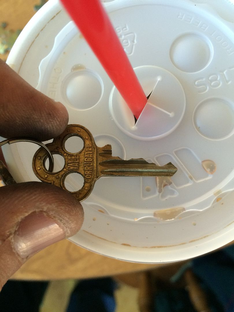

I unsuccessfully attempted this Yale today, does that count? I'm unsure of the keyway so used a Y4 I had on hand. I got a ways into it and the marks just stopped appearing. This is my first attempt to impression...

Can we see the key you tried? Sometimes we can tell what may be the issue by what the key looks like. Mostly because some of us (like me) have failed enough times to recognize the errors we have made. It can also help us to give relevant tips.

GWiens2001 wrote:Can we see the key you tried? Sometimes we can tell what may be the issue by what the key looks like. Mostly because some of us (like me) have failed enough times to recognize the errors we have made. It can also help us to give relevant tips.
Here is my attempt. Second picture is a key I hand cut, (for another yale) but had to remove the tip because the key was too long to utilize the shoulder stop, wondering if this could be part of my problem? Another thought I had last night after reading more here is if I saw a mark, I filed to the next depth, which doesn't take worn pin lengths into account.

Many times have needed to modify a blank to work in a lock. And yes, that can be a problem if the key blank is too long, since in some locks the tip of the over-long key interferes with other internal parts of the lock. On some locks, it just does not matter.
The second cut from the tip, at least in the above picture, looks like it may not be centered on the pin location. By your ramps look good.

Postby jeffmoss26 » 19 Feb 2016 19:59
Robotnik - nice Sargents!
Protec2 - can I get a nice clear shot of the code stamped on the keyway? It looks like it says GE - Y4 is the master for the G series.
