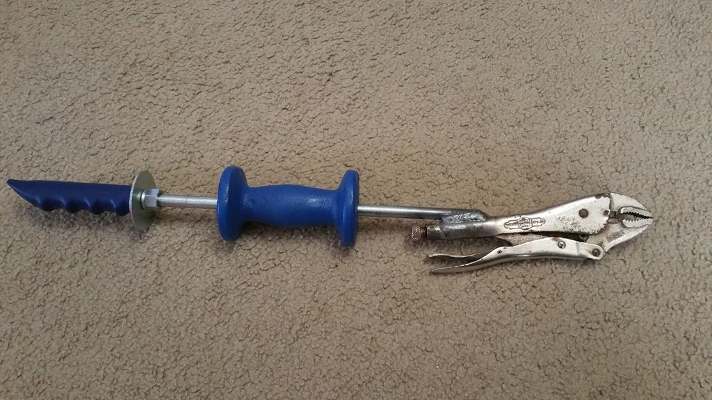

Not really lock related so i dont know if this is the place for it but i made this to remove some steel pins that were pressed into a steel plate. Since then they have come in handy for quite a few jobs.
G-lock

You should have claimed that is what you use for the 'pull to mark' impressioning technique. See how long you could string people along. :twisted:

GWiens2001 wrote:You should have claimed that is what you use for the 'pull to mark' impressioning technique. See how long you could string people along. :twisted: <BR abp="882"><BR abp="883">Gordon
I thought it was an infamous "BUMP KEY" they keep talking about on the news! You can't fool me!
