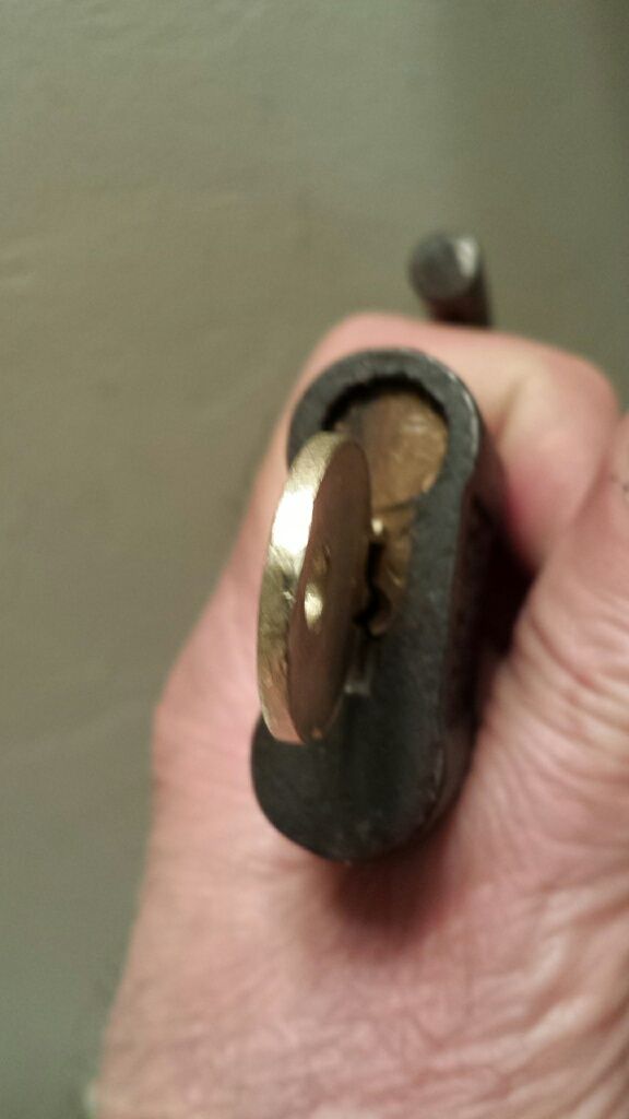

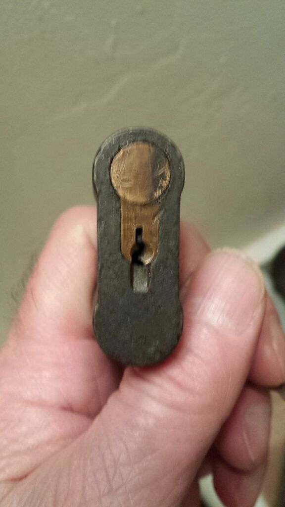

Postby stratmando » 31 Jan 2021 9:25
That's the one, when correct key inserted, does it just go up enough to open, so pins don't go into other chambers?
stratmando
Posts: 1224
Joined: 26 Nov 2005 21:54
Location: Florida Keys
Re: Yale Push Key Pin Tumbler Padlock
Postby GWiens2001 » 31 Jan 2021 14:48
Yes. It will not raise raise enough for the first pin stack to clear the plug. It raises a bit and then the shackle to gain clearance to remove the padlock.
The key can not be removed until the shackle is closed again.
Posts: 7680
Postby stratmando » 3 Feb 2021 20:30
It does make sense since pins aren't aligned with chambers.

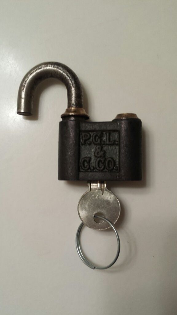

Postby GWiens2001 » 7 Feb 2021 14:50
The non-flat keys for those were referred to as their "corrugated" keys.
The flat one are still produced today.
There were two main sizes. The larger has four pins. The smaller only has three pins.
There was another one that is more unusual and harder to find. They were produced by Yale specifically for one customer - PGL&C CO. People's Gas Lamp and Coke Company. It is different because instead of the key pins pushing the driver pins/springs out of the shackle into the padlock body, the key pins push the springs and driver pins INTO the shackle.
Just a little history tidbit. Here is another about PGL&C Co. They constructed the first long distance, high pressure steel natural gas pipeline. It went from northern Texas to Chicago, Illinois in the United States. That was 90 years ago in 1932, and made industrial use of natural gas commercially viable.
Sometimes learning about the locks can teach you some surprising things about history. :D

Postby GWiens2001 » 7 Feb 2021 17:55
You can also look at the side of the padlock next to the plug and you will see the caps for the chambers. Count the caps and you will see the number of pins.
