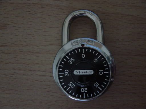

Postby MacÔda » 14 Apr 2006 18:01
Sorry for not being specific. I'm trying to open a masterlock combination lock. Here's a picture of the lock...Image

Postby jeremy » 15 Apr 2006 3:46
Okay then, the link in my previous message is to a discussion on determining the combination to locks just like the one you have.
Alternative methods include rapping and shimming. I experimented with rapping a few years ago, but I never successfully opened a padlock that way. (Maybe singing a different style of music would work better.)
I'm not familiar with the "rubber band method". Could someone fill me in?

Postby MeisBarry » 15 Apr 2006 17:18
I'm having a little trouble visualizing that method. Are you wrapping something around the dial, then pulling at it and making it spin in a single direction, or just turning it back and forth really fast in hopes that the random turning will dial the right combo?
I have a generic master combo with a keyhole in the back, and have to this date opened it three different ways. For me to be able to open a lock, trusted as much as it is by the public, via 4 completely different methods will be something I'd find amusing and a little frightening.
For the curious: I have shimmed it (curtesy of the guide here), picked it, and used a method I know that reduces the possible combinations to 100, allowing me to just systematically go through them. That's one method for each moving part of the lock.
