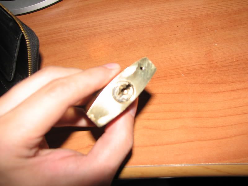

This is my first lock. Not that high tech, and I got it open 10 minutes after I opened the package (but I guess it was beginners luck since I didn't manage to open it again :P)
