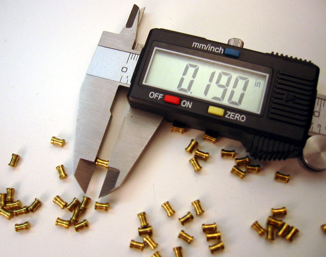

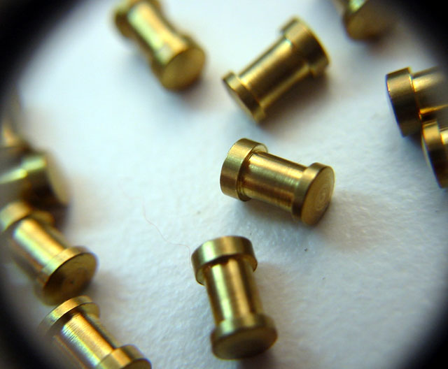

Postby Squelchtone » 1 Jan 2008 21:53
freakparade3 wrote:Here's a link for you. Merry christmas!! http://www.clksupplies.com/shop/index.p ... 327a880f90
I ordered my .190 spool pins from CLK a year ago and I seem to remember their site looking a little better than this..
direct link to the .190 LAB spool pins for $3.50 / 50 pack
http://www.clksupplies.com/shop/product_info.php?cPath=22_227&products_id=1330&osCsid=9a8797a0529bcd6d229516327a880f90
(And yes, its a 50 pack, not a single spool pin for $3.50, I'm not sure why they don't mention this fact or show a photo of the baggie they are packaged in.)
Here are photos of the LAB .190 inch pins:
