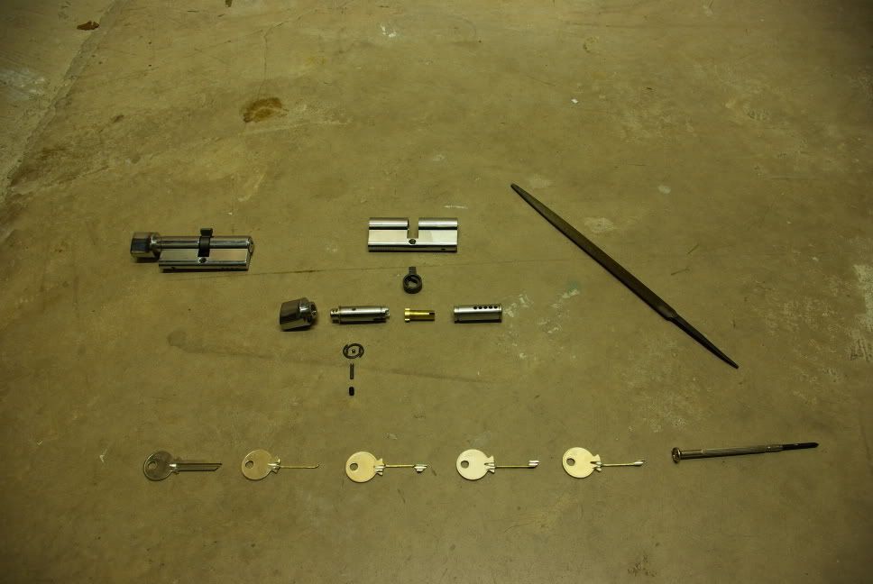

So. After realizing i was getting no where fast with my picking, i turned to bumping for some relief.
Back at uni, i tried 'forging' keys out of all sorts of things... wood, plastics, other completly different keys, so i figured a bump key wouldn't be so hard.
I also figure while i had my file out, i could file away the sides of the lock to see the pins inside, and maybe learn more about my technique from that.
So i took the lock apart, and i noticed something odd about this lock...
That metal bit which moves back and forth in the lock, is probibly there to accept both 5pin and 6pin sized keys (even though this lock only has 5 pin chambers)
The metal bit it's self, is used to turn the bolt - however, it can only be twisted when the front cylinder has all the pins at the sheer line and the key can turn freely.
This gave me an idea - what if i can twist the metal at the back, but not touch the front cylinder?
And after two days of filing in my spare time, this is what i came up with:
(for a bigger image check here - unfortunatly, photobucket downsized even that one! :( )
The first key is the blank i used.
I presume it is made from chromed brass, as it's a brownish metal as soon as i file the top layer off. Why that's important i'll get to in a bit.
The second key was the first prototype ( actually, it was the second, the first was an unbent paperclip :/ ).
It did twist the brass bolt, but only if the bolt had *zero* friction, and as soon as the pins where in the lock it just bent upwards and away from the middle of the lock where it needs to be.
The third was a key which had the end of a regular key, which had a two-fold effect.
1 - it would not bend in the lock as it would fit the keyway right up untill the end.
2 - it would fit the bolt perfectly - as after all, it was designed too ;)
Only problem with this was the shaft was too thin, so i remade it from the bottom part of the key (the fourth key in the picture) as it was thicker and the keyway was wider - unfortunatly, i forgot that the key must rotate around the middle of the keyway, so it was a total waste of time =P
The final key however, works.
Well, to some extent...
It can overcome the force of the pins pushing up, it can turn the lock when it's fully locked - however it can't get over the initial inertia of the lock without bending.
You know when you lock a lock it's a little bit stiff in turning the first inch, but then it's fairly free?
Well it's that first inch which bends this key. If i take the ball and spring out of the back, it opens it with ease.
So - what to do?
The key is as big as it can be (well, basically. Maybe i could get another millimeter of girth on it, but it wouldn't be a good solution as it would require an exponentially larger number of tries in the lock inbetween each file, and take an age).
Which is why there is a screwdriver at the end of the last key.
That screw driver is made from hardened steel, and i should be able to file it to fit the keyway and twist the bolt.
Again, it's going to take an age, but if it's harder it could become a tool rather than a disposable bendy thing you don't want to put in your pocket.
What do you guys think? Has this been done 100 times before in the past and i'm just too idle to have read about it?
What other materials/methods should i try to get this technique to work?
Can anyone help me with my picking technique? :P

I just noiced in the picture i had the third and fourth key the wrong way around. . :/

Oops, i didn't make it very obvious that i intend to file the screw driver down to fit the keyway / bolt groove at the end.

Postby mr_chris79 » 12 Feb 2009 21:39
Welcome back matey but try googling for Euro thumbturn wires, theres a few places sell them as a kit now, basically exactly what youve made but formed from piano wire , they usually come in a set with three different ends to the wires and a pin vice to hold them in, sorry if i burst your bubble, my apologies :wink:

Postby raimundo » 13 Feb 2009 13:04
Interesting Chris79, when I saw it, i immediatly realized that he was using a brass, (soft) blank, which fit the keyway, but to rotate, you simply need to use a round crossection, a hard wire, like the large number of stiff hard wires you see in the petersen sets for adams rite boltworks, I think wire this stiff and hard should do it and its just a matter of cutting and shape optimization.
Any metalurgists here know the stiffest flexy wire alloy, and a source of it?

Postby raimundo » 15 Feb 2009 11:48
considering what it does, it really dosent need the fanch brass handles, you
could buy the replacement wires and simply put a 90 degree bend in it to rotate it with. No need to have the wire longer than the reach through to the other end of the outer cylinder, and then a little bit.
without handles, the wires would be lighter and less bulky in the toolbox.
