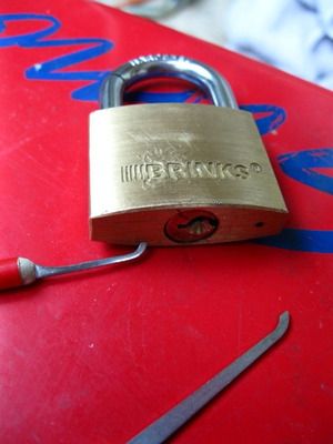

Postby atticRR » 2 Aug 2012 21:58
that looks similar to a brinks ive been fighting with forEVER! I had to cut this lock off because i couldnt pick it off a toolbox that got donated at work, it drives me crazy. I have at least 10 hrs of picking in this monster. Ill be taking all the advice given here to try to crack it. Ive actually thought about sending it to one of the lock masters on this site-just so i can see it open! t was hard to judge the size on yours but mine is fairly small, note that mine also has a mark on it to easily see the rotation. Anyway, ill be looking forward to seeing yours opened up, hope it doesnt take as long as mine has! If all else fails maybe we can trade!
also note the slim hook i made, it reaches in this lock with ease...

Postby raimundo » 3 Aug 2012 10:16
the lock is small, the key is small compared to a deadbolt key, and you need thin small picks to open it.
the photo shows a handmade hook in a kind of craftknife handle.
I suggest that the hook show is more than medium and a bit large.
make some hook with half that height and good sanding and see what happens to you ability to pick.

Postby raimundo » 3 Aug 2012 10:22
what mort duke said
and I see that in the photo of a lock on the plastic case, with the sharpie marker across the plug and cylinder to show movement, this photo also show whatmay be a
short hook well sanded, and that pick could also be a handcrafted one since I am not familiar with a commercial set that has that handle partially shown.

Postby atticRR » 7 Aug 2012 9:12
@raimundo: smaller? well, i'll give it a go. Just recently i have seen hooks that were much smaller than mine-hook height smaller.
i'll let everyone know how it works out.
