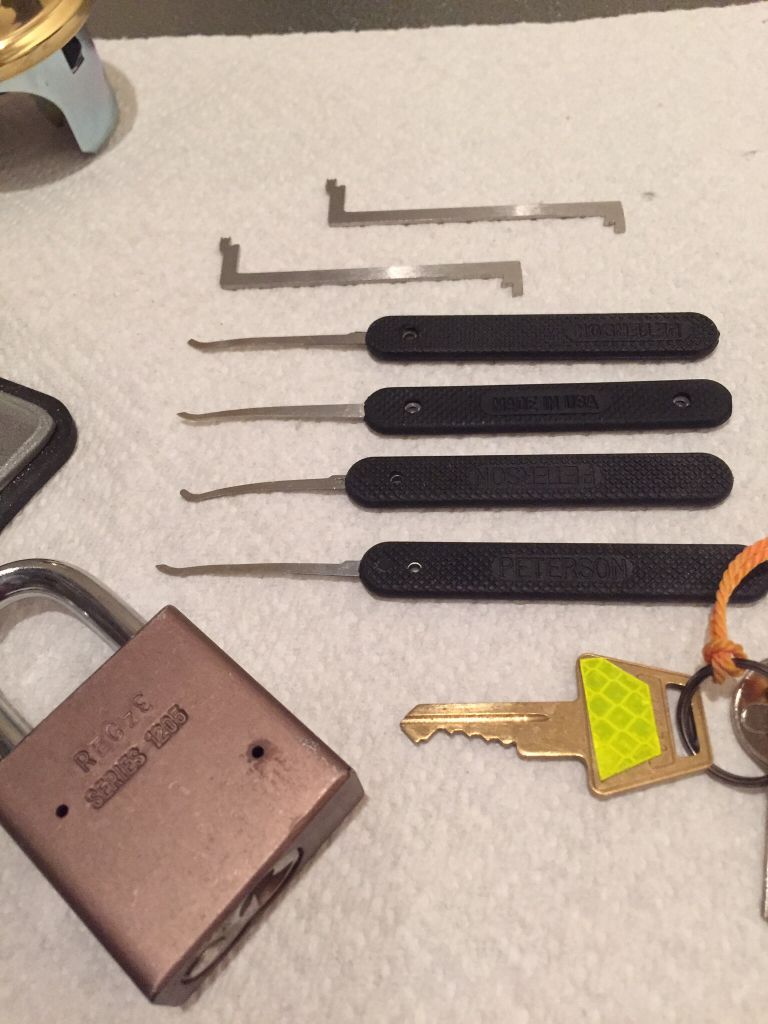

Hey guys,
I've been working on this American 1205 padlock for a few days now and have no luck with it so far. I am familiar with security pins but this my first American padlock experience. I have read everything I could find regarding the lock but yet to come across a technique that would work. The main issue for me is finding the binding pin, regardless of the tension everything seems springy. Every once in a while I find one and hear a few clicks but then......nothing. I have tried lifting very gently as to not overset the serrated key pins but that doesn't seem to help. The only thing I haven't tried yet is raking it. Can someone that is familiar with this lock please point me at the right direction.
Snakedoc

Haha, you are absolutely right about me being heavy handed. These picks are what I started with a few months ago so you can see my learning curve in them (pun intended). The issue I am currently experiencing with this lock is not that the pins are too hard to push but rather the lack of any feedback from the pins leading me to believe that the previous set pin is either over set or under set. I have tried pushing up very slowly so I can feel the clicks as the pin rides up but that doesn't seem to help. I understand that I need to keep at it and I intend to. I was just wondering if anybody has any tricks . Bosnianbill recomended to push the pins up one click at a time in his video about this lock but that is not working for me because by doing so I loose feedback on all the pins and have to start over. What I found is to push up on the binding pin till I feel a slight give in the core (false set) and move on to find the next binder....... This is where I'm stuck at.

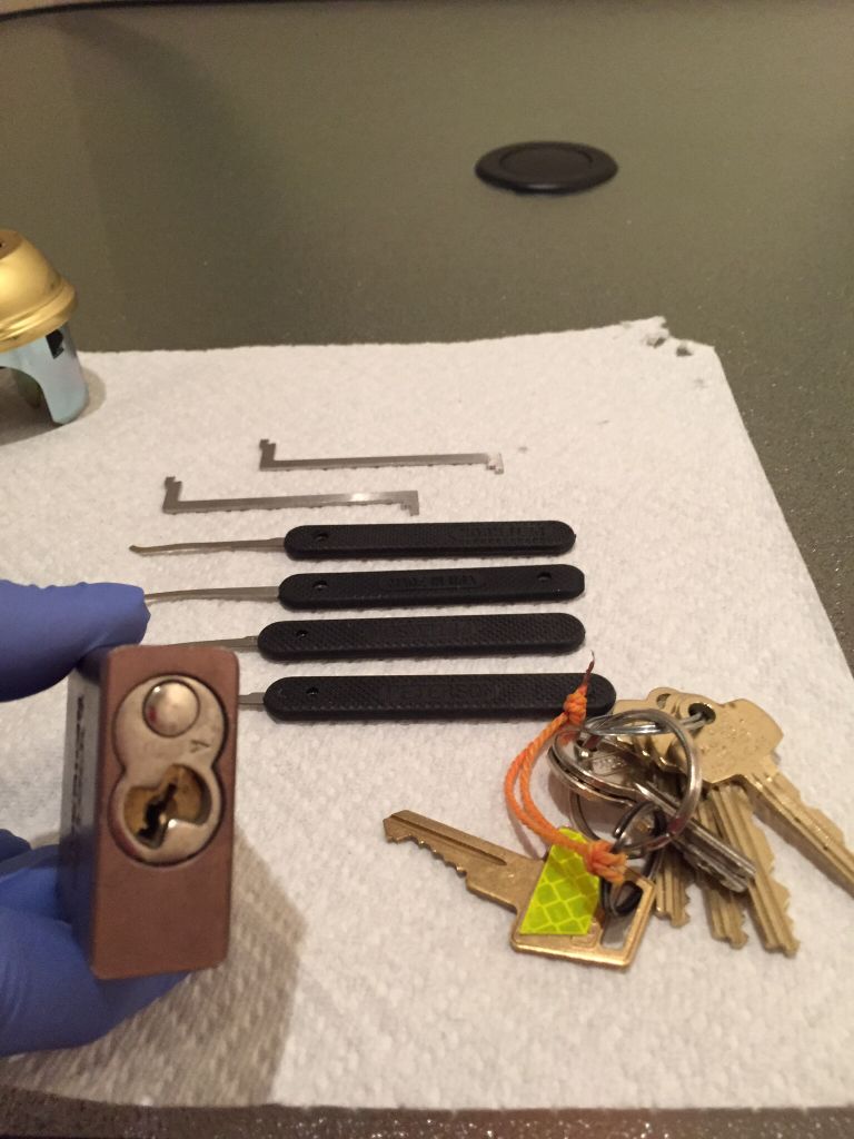

Decided to pick it the opposite direction and I got it open in 2 minutes. I bought it used from eBay and it Looks very used so I'm not sure if that could be the cause but either way...... It's open!!! Thank you guys for taking the time to comment.

How'd you pick it backwards with the steel plate there?

I used the peterson pry bar and it managed to give me just enough room for the core to rotate in the opposite direction. It will ultimately get stuck but the lock is already picked so just take it out and the core should be free to move with a plug spinner.
