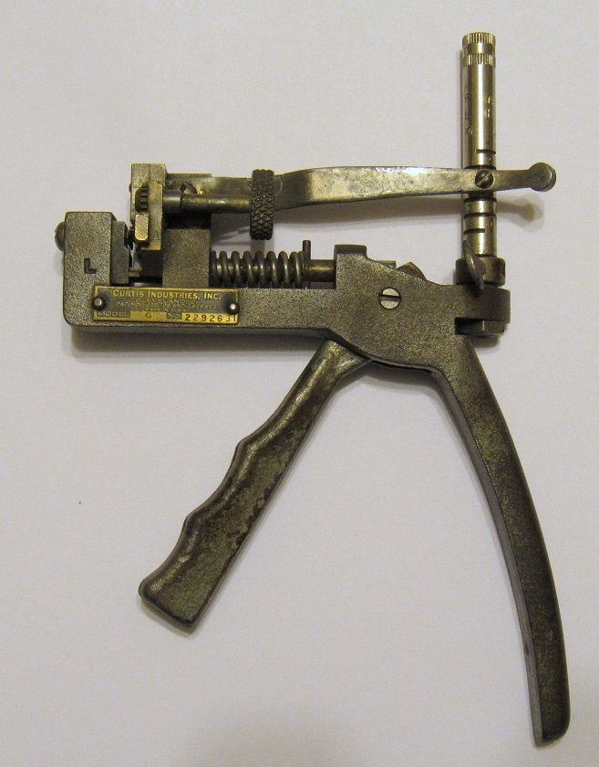

I bought this key cutter a few years ago when I first started lock picking. I don't know how it works and was wondering if I would be able to cut lock picks with it if I started with some of those metal bristles that I found in the street. Also I would like to find out more about it, is it for cutting a specific type of key? I did find several other similar tools but most were models 14 and 15, whereas mine is a model G. Also what is the value of a model G compared to models 14 and 15?

I'm pretty sure that those street sweeper bristles are used for tension wrenches instead of picks. Can someone else confirm? But one thing I can tell you is that do NOT try cutting anything made of steel with that Curtis clipper you have, i.e. no bristles or hacksaw blades. It simply isn't made to cut through such hard material, and neither are most key machines. For starting out making picks, a bench grinder is where I would look to instead.

I have a model 14 in my hand, it actually looks very similar to your model G, except mine has a wheel that contains code data
for 8 different keys mounted where yours has a shaft. I paid $20 for my model 14, I see them on E-Bay all the time under Locksmith
Equipment. These Curtis Clippers were made to cut brass keys, not spring steel, so No you will not be able to make lockpicking
tools with it.
I also have a model #15 Curtis Clipper, it also cuts brass keys--Not spring steel

Thanks for the replies and advice, looks like I can forget about my idea of cutting picks with this tool. Most likely will return this cutter to the wild at the next opportunity.

Would it be of any use for impressioning? See a mark, clip down to the next depth then dress very lightly with a very fine file?

The Curtis clipper used to be popular for impressioning, especially for GM keys,
I can't do it though, because I can never see the marks unless I file the key to a razor
edge & then I might as well finish it off with the file
