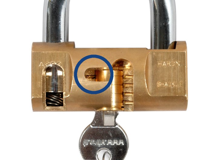

Anyone make a tension wrench using the lower part of a key?
Postby 9jack9 » 21 Jul 2017 13:40
Like grinding off everything that would engage the pins, and attaching the lower part to a bar for turning.

Postby GWiens2001 » 21 Jul 2017 13:43
Commonly done for Everest locks.

Postby 9jack9 » 21 Jul 2017 13:49
Any reason just Everest? Weird shape of the keyway?

Postby demux » 21 Jul 2017 13:52
Everest has a special check pin at the rear bottom of the cylinder. Using a key as a tension wrench properly engages this check pin, allowing the lock to be picked like any other pin tumbler lock.

Postby gumptrick » 21 Jul 2017 14:04
demux wrote:Everest has a special check pin at the rear bottom of the cylinder. Using a key as a tension wrench properly engages this check pin, allowing the lock to be picked like any other pin tumbler lock.
Yep. The same thing is true for the Viro padlocks with the cylindrical body.

Postby billdeserthills » 21 Jul 2017 15:14
9jack9 wrote:Like grinding off everything that would engage the pins, and attaching the lower part to a bar for turning.
I prefer top of keyway tension on most locks

Postby Ian_425 » 22 Sep 2017 0:13
I prefer top of keyway tension on most locks[/quote]
Problem is that top of keyway doesn't work in the above situation. But with the amount of posts you have made on here, I'm sure you already know that.

Postby femurat » 22 Sep 2017 0:22
Why TOK won't work? I always use TOK to pick locks, this one included.
Is a 5 pins lock so you have to pick 5 pins.
