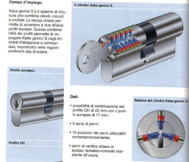

Postby Eldoc » 2 Jun 2005 13:21
Hey Eschatos
A Kaba Gemini with only 6 ditches on the key?
I know Kaba 8. Kaba 20, Kaba Gemini, Kaba Gemini S, Kaba Star, Kaba ExperT, Kaba Quattro S, Kaba Penta: the last born from Kaba.
May be it is a furniture's lock, but i know kaba has minimum 8 pins in his more simple cylinder (Kaba 8).

Postby master in training » 2 Jun 2005 13:34
i've got a kaba gemini, i couldn't work out how to dismantle it, but i know that when Eschatos says the key has 6 ditches on one side, that means there are a possible 6 pins on one side, then theres the 6 on the other and 6 on the top, but not all pin holes are filled.

Postby Eldoc » 3 Jun 2005 8:45
[img]http://i7.photobucket.com/albums/y281/Eldoc/KabaGeminiS.jpg[/img
Thanks again Ezer
Eldoc
Posts: 16
Joined: 29 Apr 2005 11:35
Postby Ezer » 3 Jun 2005 11:02
You've got everything but the last bracket. Otherwise great job. :)
Hope you don't mind. I made it a little smaller to try keep it from stretching the page out.
