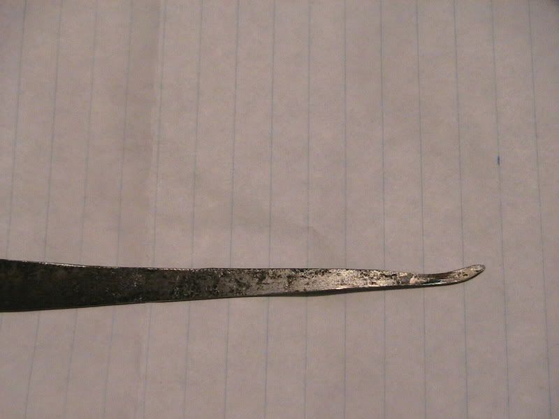

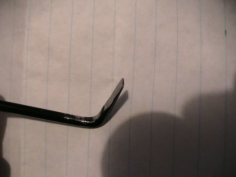

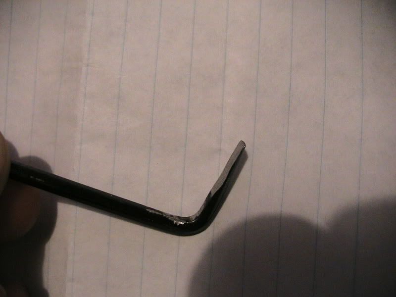

Alright, Since the last picks I made weren't so good, I made some new ones (well only one and a tension wrench). Here are the pics what do you think? And any advice to improve them?

Postby dougfarre » 30 Oct 2007 21:05
take some new pictures with an to measure off of like a quarter or something.
But otherwise man, they look pretty good, i would make the feeler pick have a longer stem. So shave off a much of that incline you built. You kinda want the whole pick to be the same width, none of this fatter near the handle stuff.
Also i counted the number of lines on some notebook paper and it looks like its long enough to where you can cut it off where you stopped sanding and wrap some tape around it.

Postby mcm757207 » 30 Oct 2007 21:09
Still not fantastic, but leaps and bounds from your others. Good start.

Postby Wrenchman » 30 Oct 2007 22:02
Gekko wrote:Would these ones work for you?
No, this pick is no good, trust me, but the wrench looks ok!
This one is not nearly as cool as the coat hanger, try and make the coat hanger look like this one(a small hook) and I'll promise you, you will be a happy lockpicker!

Postby Gekko » 30 Oct 2007 22:14
dougfarre wrote:take some new pictures with an to measure off of like a quarter or something.
Thnaks alot! I will shave it off to make it thinner like you said. I was thinking of that but I thought it would'nt really matter. But thanks! :) And I am definitely going to cut it off, because a long thing isn't quite good is it:) Thanks for your help Man!!

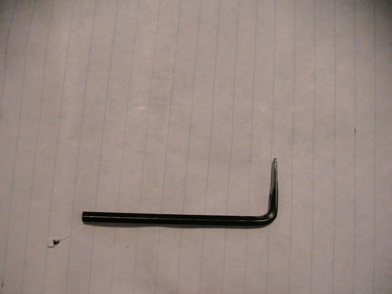

Postby Gekko » 30 Oct 2007 23:06
Wrenchman wrote:
Gekko wrote:The material on a coat hanger is too soft.
Soft? Butter is soft, a coat hanger is good(not perfect) for lockpicking!
Gekko wrote:I might try to fix up the coat hanger after I've fixed up this one.
That would be the least you could do and you'll be thanking me afterwards!
Gekko wrote:I'm not saying exactly where I'm living right now but, I used to live
in South Africa, but I moved to Somewhere in North America(not saying where).
Hmmmmm sounds interesting, secret agent?
:D
Wrenchman
LOL, secret agent. Well, actualy I just gave the coat hanger a quick file down and you were right! And thanks:) It does seem to be fine pick. It's almost the same size and width as the hacksaw pick just has a bit more of a curve.
They're in comparison to a disc because thats all I had lying around :) Check it out:
Which one do you guys(or girls) like better? :)

Postby brianmay27 » 30 Oct 2007 23:45
ok. having a bit experince with using a blade saw, yours lookes like it needs to be grounded down a bit more. i used a angle grinder and they work the fastest. i would say you may want to make it the handle smaller. just take two pliers and snap it where you want it. it will snap easaly. grind it down to a very thin point. like 3 mm. it should hold just be gental near the end

Postby Jaakko » 31 Oct 2007 6:35
After you have ground that pick a little smaller, use some 120 and 240 and 400 grit sandpapers to round any corners and polish the surface of the pick. This way you don't scratch and destroy your locks and you are able to feel those pins sensitively.

Postby JackNco » 31 Oct 2007 9:55
IMHO the tangs don't look straight and they look to rough. they also look to thick (high). BUT you could say they are a work in progress and thin and straighten them as you find you need to. good start though.

Postby Wrenchman » 31 Oct 2007 11:11
Gekko wrote:
Jaakko wrote:After you have ground that pick a little smaller, use some 120 and 240 and 400 grit sandpapers to round any corners and polish the surface of the pick. This way you don't scratch and destroy your locks and you are able to feel those pins sensitively.
Sorry, which pick are you talking about?
He is talking about both of them!
In fact, you should always sand your picks, all your picks!
