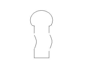

excuse the crude drawing, but for 30seconds on paint it gets the point across.
that's what the lock looks like and have spent about 30minutes trying to pick it already.
I THINK it may be a 'union' lock.
but since i've lost the key, and the spare key is in the room, i can't be sure.
i don't have any tools, just home-made things that are almost as crude as the drawing of the lock.
but i need into my room, cos my car keys are in there.
and other than kicking the door down, i have to pick it, but really have no clue where to start.
I would call for a locksmith but im kinda broke these days, and couldn't afford it.
The lock is on an interior door in my house, the door for my room to be exact.
i can see through it to my room....just need in there.
And i am seriously close to kicking it through, so any advice would be apreciated.
btw-im in the UK, in case that helps *shrugs*

No, really though Dave. If I'm to guess (and I'd have to because you didn't fill in your profile) you're in Europe some where and that is either a basic warded lock, or a lever lock. You'll need a couple stiff wires bent in the shape of an L and a whole lot of luck if you're to get this quickly. If you're bent on getting it, search the forum for picking lever locks and warded locks and see if you can figure out which it is. But there is at least a pretty good chance that you'll spend a bunch of time and still not get in as quick as you need.

Dave, If it's a union it looks to me like a 3 lever lock. I'd be using an over lifter pick on it, but you haven't got one of those and they're a bugger to simulate. If you've got some pliers and a coat hanger and aren't an expert lockpicker i'd be trying to make a button hook.
Problem is, it ain't easy to button hook three levers. Button hook is shaped like this.
_____
I
I
I I
I________________________________________I
This end ito lock This end as a handle to turn
Assuming the lock is on the left hand side of the door...
You need to put the button hook into the lock at about the 11 o'clock angle push up and turn to 1 o'clock at the same time. Keep trying.
If you'r in North Wales o'r chester and want someone to look at it then give me a call. 01352 716056. I promise it's cheaper than fixing the door afterwards!
P.S. If locks on right then start at 1 and lift and push to 11.
