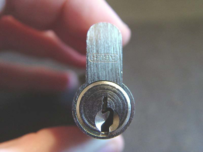

Postby n2oah » 4 Jan 2006 16:51
searsman05 wrote:And while on the subject of these locks what in your opinion has the nastiest key way to pick?
Nasty Keyway?
That is on one of Zeke's locks. To my knowledge, he has not picked it yet.
Another feature medeco is lacking is an ugly keyway. If they had a horrible keyway, it would make their locks nearly impossible to pick, especially with the addition of counter borings .
