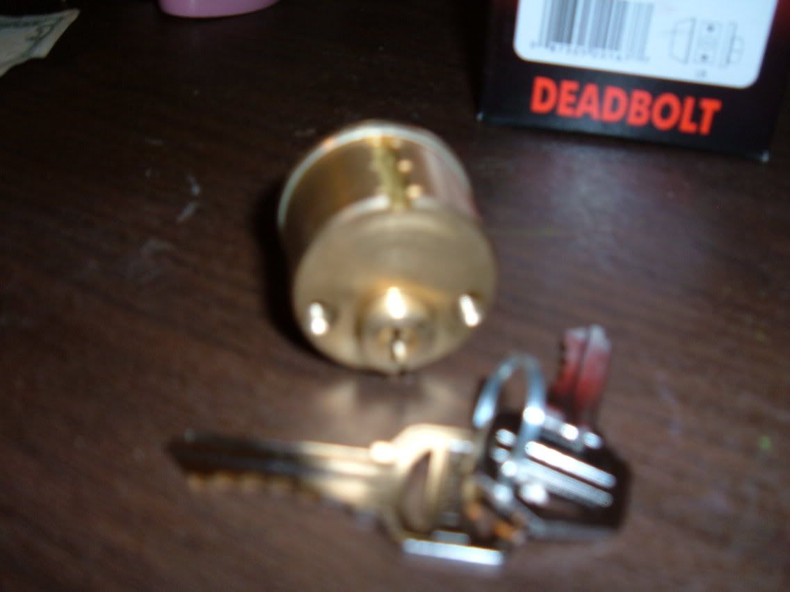

Postby mjsotelo91 » 29 Apr 2006 13:29
ok guys heres 2 pics one better than the other if u would like me to take a of the 2nd one again i can and just to let u know there big thats why there links
http://i61.photobucket.com/albums/h56/m ... ock001.jpg
http://i61.photobucket.com/albums/h56/m ... ock002.jpg

Postby Shrub » 30 Apr 2006 17:01
Use a junior hacksaw blade with the teeth intact,
Press the teeth onto the brass plate that is on the top of the pin chabers and try to slide it off towards the back of the lock,
Do this in a bag so you dont loose any bits, that should let you remove the pins and spring/s then start again.

Postby Shrub » 30 Apr 2006 20:06
It should be just pressed in not soldered or anything, you may destroy it if not carefull but as its a pracise lock you will be able to fix it so it works again quite adequately.
