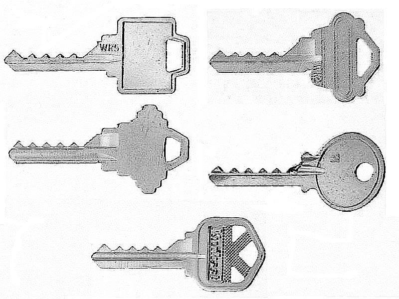

Here is a rather poor photo of the space and depth keys that the vendor mentioned in the first post is selling
He includes Schlage, Yale, Westlock, Weiser and Kwicklock. all cut by code to the deepest cut for that blank.
Just to remind folks...... in of them selves these keys won't bump locks, until the shoulders and tips are ground down a bit.

pickmonger wrote:The blanks look like schlage, westlock, weiser, kwickset and Yale. Can anyone confirm this.
The first is a schlage. My home key is a schlage and has the same design (except for the teeth).

Pickmonger, can you modify the picture you sent to show how the shoulder and tip should be modified? Cool topic!

um, I understand how bumping works, and have gotten a set of bumpkeys, but was also wondering what type of modification has to be done. I'm assuming it's that the shoulder and tips that have to be shortened to make better, smoother contact with the pins? Thanks guys...and yes, I joined before the MSNBC story, and actually never even saw the story. Thanks.

So, should I file them down a bit until smoother contact is made? Or am I deburring the key? Thanks.

No. When you isert an unmodded bump key into the lock fully, what happens when you hit it? Yup, absolutely nothing. In order for the key to move inside the lock a bit more, you need to file a bit oof the shoulder, and off the tip, this lets it get further in the lock than should be possible.
The alternative technique is to merely pul the key out one space and then bump like that, but it's less effective. :)

Oh, I understand what your saying man...after watching an animation of how bumping works, I understand that what you said makes sense...it has to be able to go past the pins just slightly, if I see this right, so that it can release the pressure front he key into the pins, um, am I right? Thanks man.

The peaks of the key have to bash into the pins, and this causes the pins to seperate, due to a phenomenon I'm sure you already know about. If the key is not aloud to enter the keyway a bit after it has been bumped, then you merely make nice little dents on the plug of the lock, but little esle happens. :)
