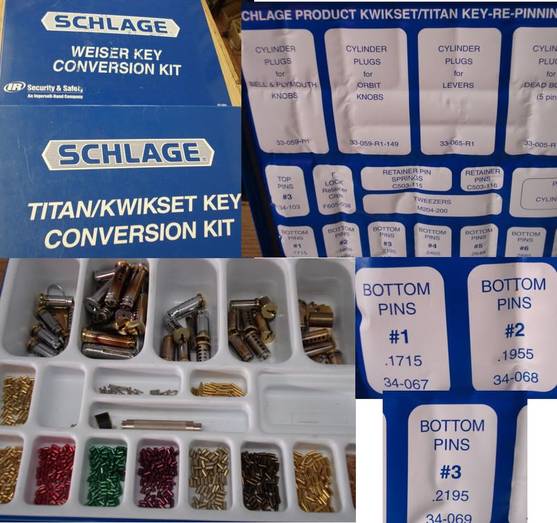

Schlage has plug kits that will allow you to key a Schlage lock to KW1 and WR5 (Weiser). The kits include about 6 different plugs in 5 pin and 6 pin configurations, and for different models of Schlage locks (ie: F series Orbit and Bell knobs, which have different length plugs, and B series locks) and in Silver and Brass finishes. Also includes the different bottom pins for a factory cut Kwickset or Weiser key.
I'll take a pic of the kits and post up soon.

Postby I Pik U » 28 Dec 2006 19:03
Here's a pic of the kits:
