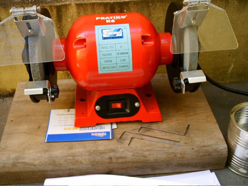

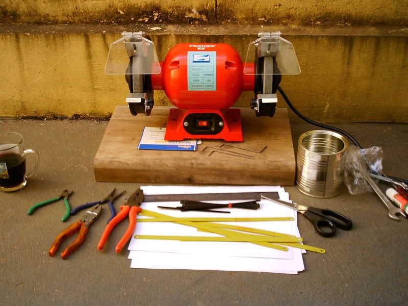

I bought the grinder today, here it is, and the picks I made.
Grinder:
Grinder, pliers, hacksaw blades, coke, scissors, water....
