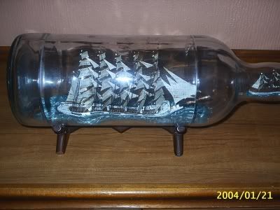

Postby scampdog » 6 Sep 2006 19:32
ships in bottles are reasonably easy if you take time to make everything collapsible.
but a lock in a bottle, is a totally different kettle of fish. the only way i can see of doing it ,is to cut the lock body into three sections, very accurately, then drilling and pinning the centre section,and drilling the two other sections to match up with the centre one. assemble the pieces outside of the bottle and clean up all the joints as smooth as possible. you will need to make up some makeshift tweezers to allow you to work inside the bottle.insert the sections and apply superglue to the body parts(NOT THE PINS)and press together. the shackle could be fitted, by cutting the top of the shackle bend diagonally, insert in to the shackle holes apply glue to the cut diagonals and fix in situ.
sorry about the sketching (useless with a pencil ), sounds like a really good project,when you get it done, don't forget to post it for us.
