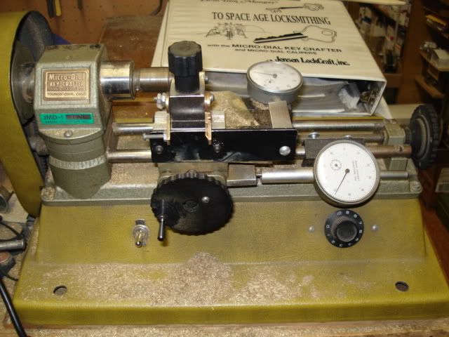

A Jenson Microdial keycrafter is an easy to use machine.
Not sure how well it will hold double sided car keys though, as we never cut cars keys on it.
The vice is limited to two sides, both being just straight clamps with no edges to fit into blanks, one shallow and the other deap.

I Pik U: What a very nice machine :!:
Could I encourage you to post detailed pictures of the vise, in particular? I am in the process of modifying a small lathe in order to make one-off lever-lock keys. What I am missing is a good multi-jaw for holding different diameter blanks.
Any more info on the machine would be absolutely great :mrgreen:

Postby I Pik U » 2 Oct 2011 9:10
I will take some more detailed pictures, including the vice area.
