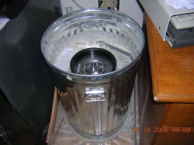

We've built a lot of safes and coin boxes for customers over the years. Some were quiet elaborate and expensive but some were rather simple and inexpensive to put together.
Some of my favorites that we ever made (and the hardest to get in to) were coin boxes for some car washes. They were simply steel tubes with the door recessed about 16" and a hockey puck type padlock on the lift out door. The tubes were encased in concrete pillars.
This is another example of a very easy safe to create and trust me, you're not going to just pick it up and walk away.

I had a good idea of what I wanted to do, but now I'm not exactly sure. It'd be nice if I lived in an area where they made such thing and could work there for a while. I only know of one actual locksmith in this town and he doesn't seem to be extremely busy, but I don't know for sure.
The trashcan safe is a nice idea, but it would almost have to be relegated to the garage, or some such.
