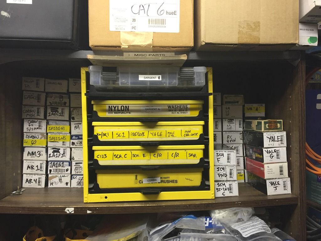

Postby jeffmoss26 » 19 Mar 2016 21:14
Here is my updated storage setup:
L to R
American, Arrow, Corbin 60 keyway, Corbin large bow 59 series, Eagle, Falcon, Best SFIC (in boxes)
Sargent L series, Sargent R series, KW1, SC1, Master/American padlock, Y1/Y2/Y11 etc, Misc cylinder and wafer blanks
Schlage, Corbin Russwin 5 and 6 pin (common kewyays), Sargent LA, RA, LN, RN 5 and 6 pin
Corbin 27-57-67-77-59, Russwin D1, D2, D3, D4, L1 etc
Ilco, Lockwood, misc keyways, Sager 1047CL, more Schlage, Sargent overflow, WB A thru D keyway, Weiser, Weslock, Yale 8FL, V/Y/Z, G/S/T, small paracentric, J/K small sectional
I think that's it lol

Re: How do you organize your blanks?
Postby GWiens2001 » 19 Mar 2016 21:19
Excellent, Rumball. You can never have too much room for expansion.
Used to sort my blanks by type as well. Just ran out of space to keep them entirely separated. Still, Auto is entirely on the right board, flat steel keys are along the bottom of the center and left boards, lever started at the bottom of the right board, then sort of crept up the left side of the left board, pin tumbler is most of the rest, with some specialty keys all over.
Jeff, nice in the boxes. :D
