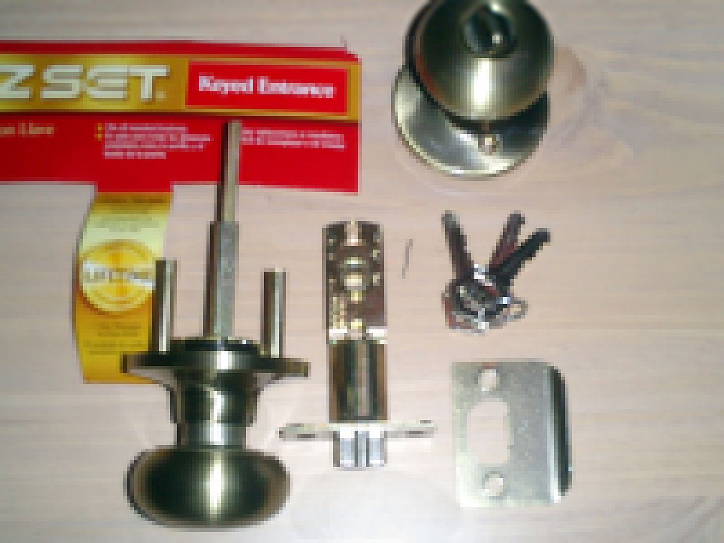

ok i got some EZ Set lock heh dont no much about it but here are some pics..
If you need more info ill try to find it....

Postby MrB » 14 May 2005 14:03
OK. If you want to take it apart, here is what you do.
If you look at the side where the knob is joined to the rest of the lock, there will probably be a small hole. It almost looks like it is visible in your photo on the right hand side. With the knob unlocked, you have to turn the knob almost all the way to the right against the spring return, and then push a small screwdriver into that hole. There's a kind of spring there that you have to depress. While depressing the spring, you have to pull outwards firmly on the knob to pull it away from the lock body. There's a bit of a knack to it and it may take a few attempts to succeed. It may be easier with three hands too, unless you can hold the lock in a vice or something.
After you detach the knob from the lock, I think the lock cylinder should simply fall out out of the knob. It may be held in place with a clip or something, I'm not sure.
When you have the cylinder free, you can think about removing some of the pins from it. To do that, you really need a plug follower and some patience. Don't do the next step until you are comfortable with what is going to happen.
Comfortable? OK, let's proceed. On the back of the cylinder should be a knurled brass ring with a little spring-loaded pin in the end that stops it unscrewing. If you push down the pin (the plastic tube from a BIC pen is good for this) you can unscrew the brass ring and remove it with any other pieces it is holding. Don't lose the little pin and spring that may fall out at this point. Now, put your hands, the cylinder, and a key inside a large clear plastic bag. Carefully push the key into the cylinder, turn it about a quarter turn and smoothly pull it out. If you have done it right, the plug will come out with the key, and pins and springs will go flying everywhere (hence the plastic bag to catch the bits).
If you get this far, the next step is to put it back together with fewer pins in. There are other posts that explain how to do that, so I will break off here and post some links to them later when I have a bit more time. Or you could do some searching and reading in the mean time.
Good luck!

Postby vector40 » 14 May 2005 14:45
*squints at the key*
Is that six pins? Seven?

Postby MrB » 14 May 2005 14:49
I think that's just blurryness. Those locks usually have five pins and use a Kwikset key blank.

Postby jjrythem » 14 May 2005 18:09
heh got a problem i took it apart so now i only have the knob but i cant get the cylinder out of that... lol

Postby jjrythem » 15 May 2005 18:04
ive looked t it and i dont see any way of getting it out :/ lol

Postby MrB » 15 May 2005 18:12
I'm sorry, I really don't know how to do it. From looking at your photo, the cylinder should come out the back of the knob somehow. It doesn't look like it can come out the front (which is what happens with Kwikset knobs).
If you put a thumb on the face of the cylinder where the key goes and push firmly, it doesn't spring out the back? There are no retaining screws or clips you can see anywhere?
Unless someone knows exactly how this particular knob works, I can only suggest you post a picture of the back and front of the knob. Make the picture as sharp and clear as you can; the last picture was a bit too fuzzy to see much detail.

Postby vector40 » 15 May 2005 18:19
Key-in-knobs can be weird :/ They're not as standardized in construction as padlocks.

Postby Mad Mick » 15 May 2005 18:25
Looks very similar to an unmarked lock I got given some time ago. This thing came apart by picking to a certain position, then using the pokey-hole that MrB offers. The knob came off, then the plug/shell came out the back of the knob.

Postby MrB » 15 May 2005 21:10
Given it's a real cheap lock, it probably doesn't need a special control key to get the cylinder out. Try putting the key in and turning it, and see if that frees the cylinder somehow.

Postby jjrythem » 16 May 2005 14:20
lol i got it to come out lol i got a pen n pushed it from the front and it was a pain to get it out cause there was some thing sticking out of it. Now what do i do? i didnt get what i have to do for this part
