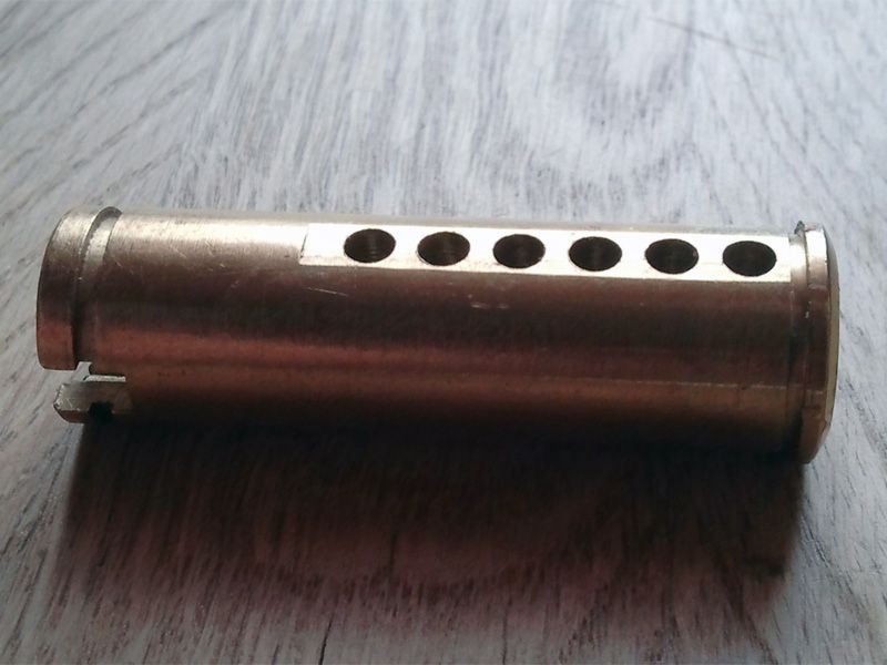

This is from Yale cylinder, someone has been enthusiastic about filing...
Normal diameter is 12,90mm and from the filed portion´s other end it´s only 12,15mm :shock:

Re: Filing barrel
Postby Altashot » 5 Jan 2013 16:44
that is one fugly cylinder. Thanks for posting a picture of what NOT to do.

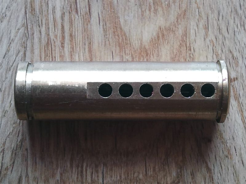

Postby femurat » 18 Feb 2013 8:43
Here is an original, not filed, yale barrel from an euro profile cylinder. The flat area helps it work smoother even with a little wear on the pins and with copied keys. I haven't measured it with caliper, but I guess it's less than 1/10 mm off the surface.
