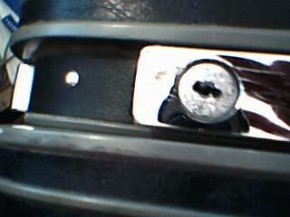

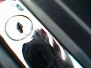

Postby themanofmen » 30 Dec 2005 12:30
thanks for replying, ill post a pic now. The manufacturer is samsonite but its an old bag.

Postby hzatorsk » 30 Dec 2005 12:54
Dig out your lockpicks and put a little tension on the plug and lift those discs (the movable plates inside the lock) into position.
No picks?
You need to find something that can be used as a pick to raise the discs into and another 'something' that will simultaneously allow you to turn the lock as if you had a key in it.
The something that turns the lock should not get in the way of the something that raises the discs into position.
Since you don't know how far to raise each disc.... you'll spend some time playing with this... jiggling them... bouncing them.. and raking your 'lifting tool' gingerly (not harshly) in and out of the lock. Vary your 'turning force' or tension varying amounts so the pins don't bind up.
The lifting tool is your 'pick' and can be about anything small like a stiff paperclip. The turning tool is your 'tension wrench'. It is usually small flat and L shaped... a small flatblade screwdriver can work.
An amateur should be able to get this open in just a few minutes.
(This looks like a disc wafer lock... if it is a pin tumbler lock... the concept is identical)
Good luck.
