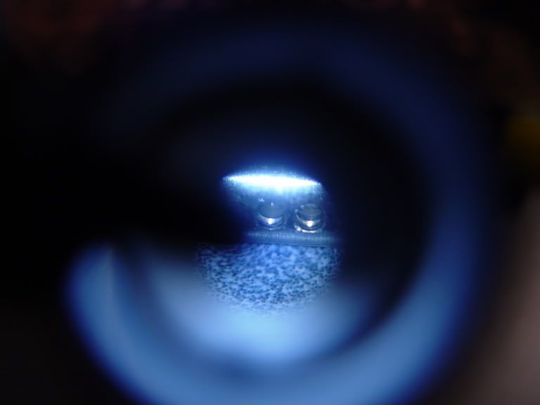

Another factor is the rotating pins on the Schlage Primus. If you have ever watched Zeke's video of the primus breakdown (availabe on his site, under the advanced section), you will understand the concept. I will take some pictures of the rotating pins on my Everest Primus cutaway in a few minutes.

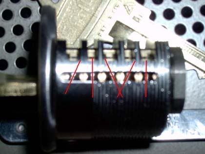

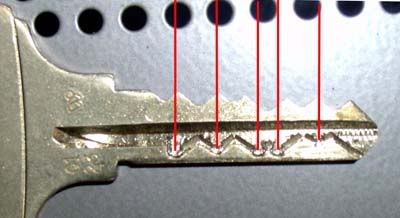

Postby n2oah » 2 Jan 2006 18:08
I stand corrected, but there are only 3 mushroom pins. It also looks like your lock only has 1 false slot for the sidebar.
I think your best bet would be to ask Zeke which locks are harder to pick. As far as my knowledge goes, he is the only person here that has picked the Primus and a Medeco Biaxial.
Here are the Primus key rotations if you would like to see them.

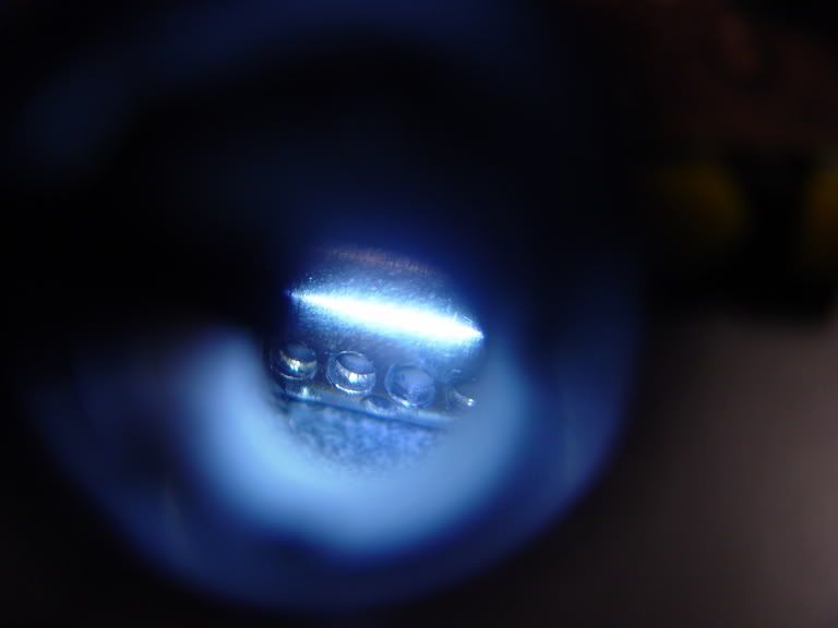

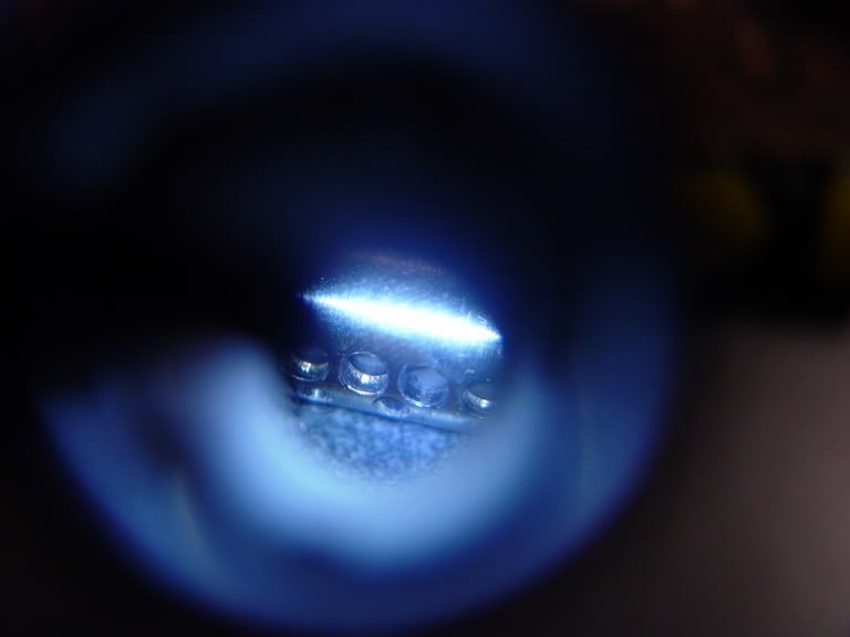

Postby n2oah » 2 Jan 2006 18:18
Nick, no need to search for the pictures of the countermillings. I remember that you sent them to me on MSN one time.
Here they are:
