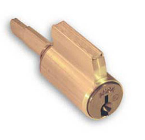

Unless it is some fancy high-security lock (which i doubt, as i believe it to be a simple pin-tumbler cylinder lock like this one http://www.new-york-locksmith.com/Items ... drical.jpg ), the pins should be very easy to set, when pushed up all pins at the same time with a long and flat piece of metal, while applying tension to the lock.
Anyway, if this lock has a standard key, with cuts on one side and a flat surface on the other - i don't see any reason why it shouldn't work.
