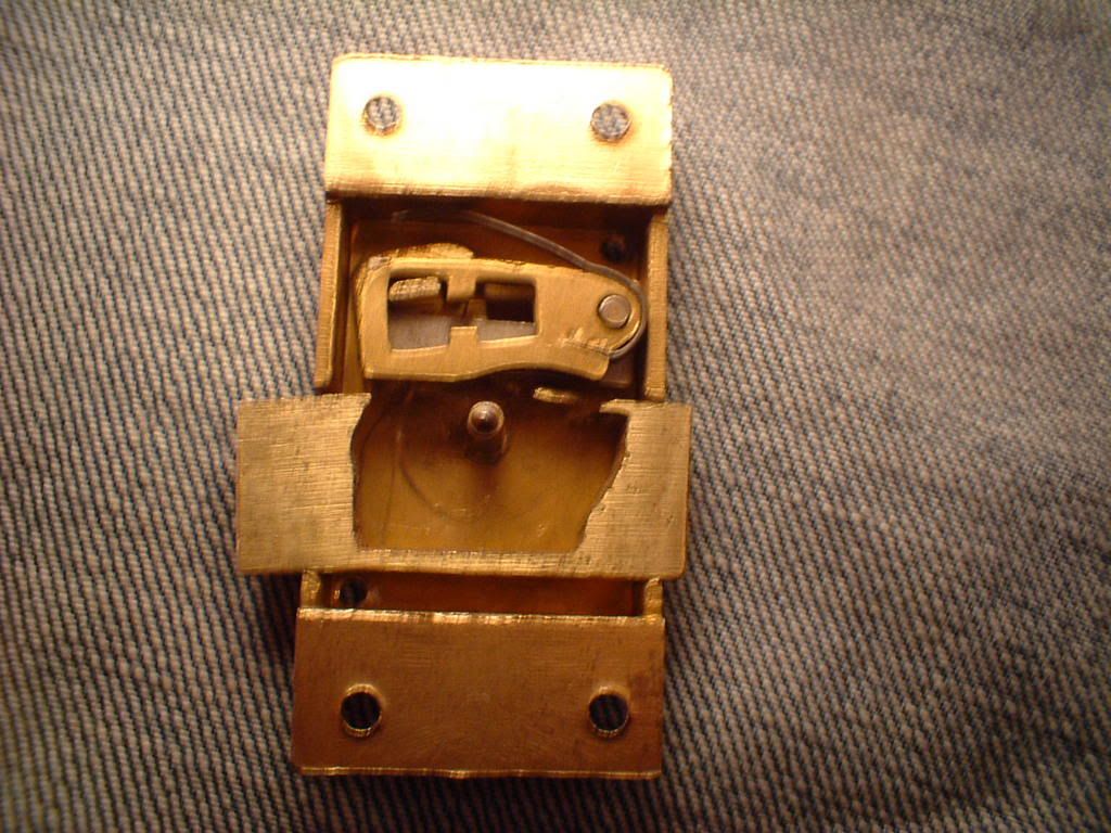

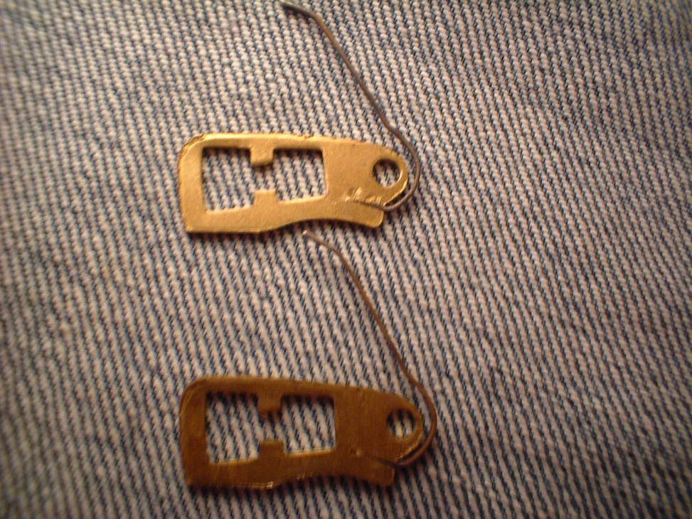

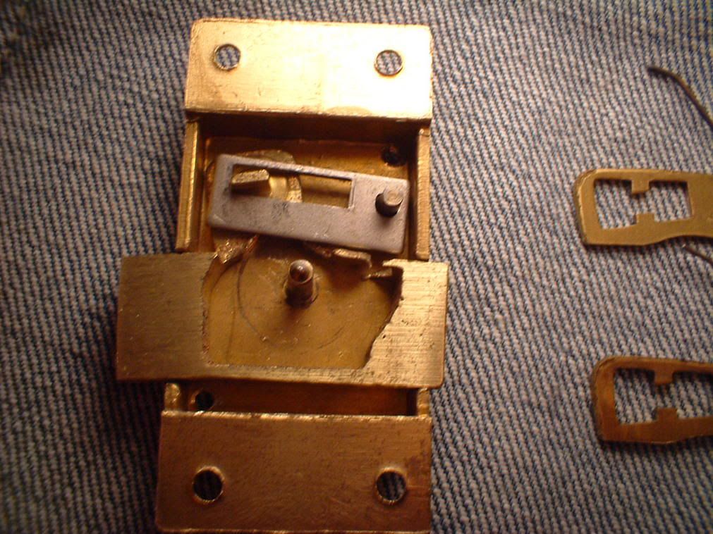

Incidently I took the liberty of getting some photos of my 2 lever cabinet lock, perhaps they'll be of use:
The inside:
http://i16.photobucket.com/albums/b25/jangofett511/DSCF00751.jpg
The bolt:
http://i16.photobucket.com/albums/b25/jangofett511/DSCF00791.jpg
The 'levers':
http://i16.photobucket.com/albums/b25/jangofett511/DSCF00781.jpg
