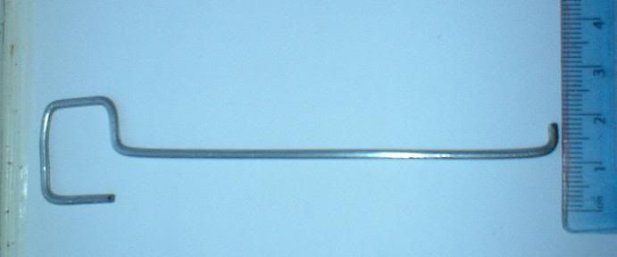

You may want to consider this:
It's nothing more than a bent bicycle spoke, but works well. You put it all the way to the back of the lock, and feel for a springy part - when you feel this, turn the pick slowly and the lock will open.
You can also file/grind away at a key as said by eric. :)
If you have access to Locksport Archives there's a video I made showing the process.
Hope this helps. :)
