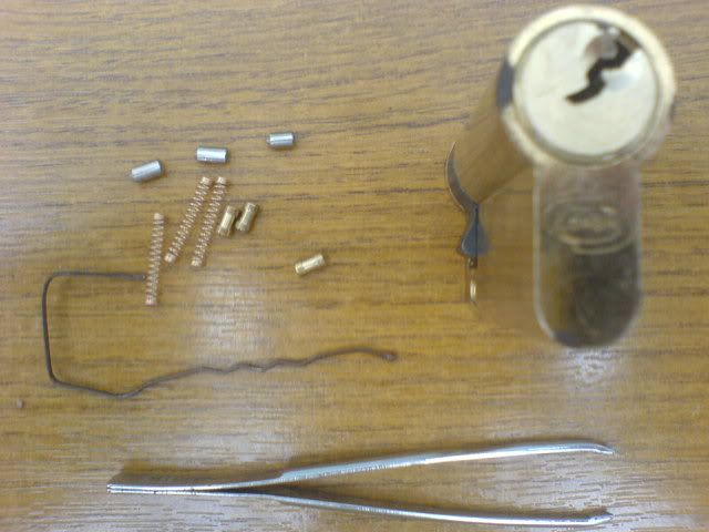

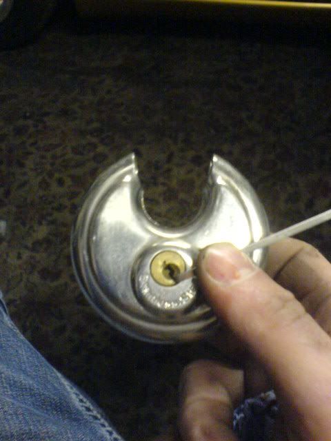

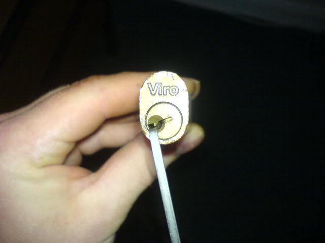

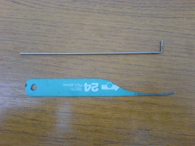

After read this site for a few days decided to get a lock and have a go at picking it results were good.

tools
1st lock
2nd lock

congratulations

Congrats indeed, you might want to get a cheap pin tumbler to repin.
There are several guides on beginners exersizes and how to repin the lock, good luck on it.

just repined my euro lock
but leaving 3 pins out. these pins have cut outs in them wot does that mean?
i can pick it in 10 seconds with only 2 pins lol

Postby illusion » 26 Feb 2006 9:36
Those are spool pins.
Along with mushroom, and serrated pins they are broadly known as security pins.
They hinder picking if you apply too much tension, but if you simply learn to use the right amount of tension they generaly offer little hindrance.
Changed the order the pins are in, put a big bottom pin next to a little pin, if you want to make it quite hard then go: big, small, big, small, big... that'll make it more... fun. :)

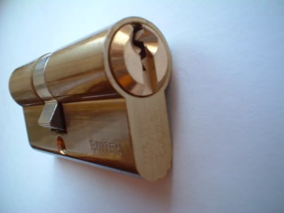

CPLP:
Look for something like this:
Another view:
If you already have one but don't know fully how to do it, add me to MSN. :wink:
