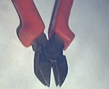

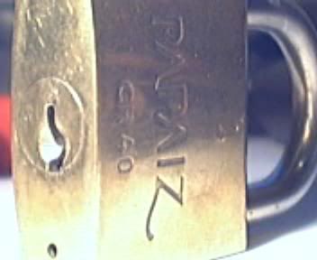

A padlock from Papaiz and a Wire cutter from Mayle
Image Image

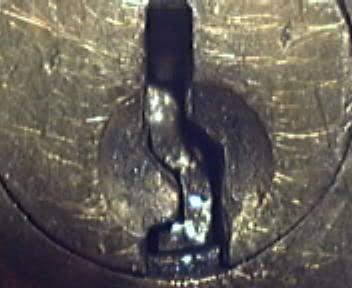

A Padlock without a broken key and a padlock with a broken key!(it is the same lock)

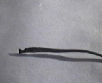

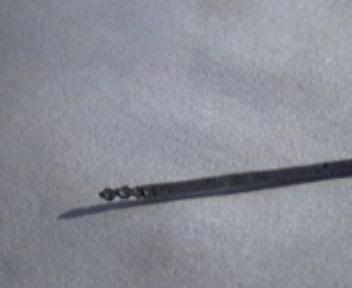

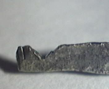

Close-up of the special tool developed to take out the broken key extractor piece

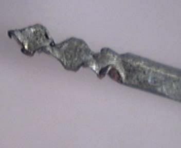

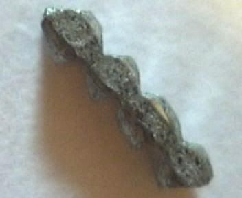

Close-up of the new key extractor, that took out the broken key, after the old key extractor piece went out!

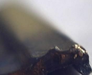

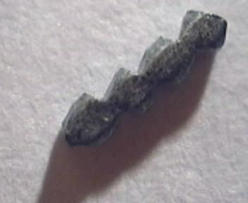

Extreme close-up of the broken key extractor piece X 2, it is about 5mm in length!

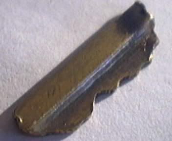

The broken key which came out, in fact the same day, notice that it has a burr in the end of it, could be due to the fact, that, I did hammer on the broken key while it was in the lock, hoping that I could get the broken key further into the lock :roll: and that the broken key extractor piece would stay in the front, and thereby fall out, but no! :shock:
Like I said, the key extractor broke in side the lock together with the broken key, because it got stuck, and I took a plier and pulled real hard, thinking that I could take out the key by force, :o, well the key extractor obviously had a weak point!
The "broken key extractor piece remover" is less than half a mm in width, and was put in between the broken key and the keyway in the top right corner just below the first pin, where the broken key extractor piece was seen stick out!
