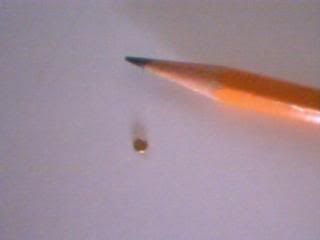

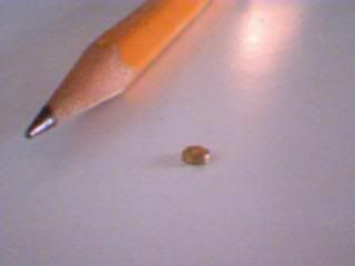

Postby Erasmus » 9 Apr 2006 22:13
Another update: Chucklz' suggestion led me to examine the MIT Guide, which, it turns out, has a section on master-keyed locks. There's another pin segment, a spacer, which is what I suppose Chucklz referred to as a "masterpin". Anyway, the MIT mentions that it can fall into the keyway and get wedged inside, as was the case with me. It mentioned that the only solution is to remove it, so I did.
The key now fits all the way into the keyway, but does not turn. I can't think of any reason that the loss of a spacer would cause a pin not to line up properly with the sheer line... could I be missing something?
I have some pictures of the spacer, and will post as soon as I figure out how (the usual [IMG] thing doesn't seem to be working).
-Erasmus

Postby Erasmus » 9 Apr 2006 23:49
So, is this thing a "master wafer" or spacer?
-Erasmus
Erasmus
Posts: 6
Joined: 9 Apr 2006 18:21
Postby What » 10 Apr 2006 0:02
yes, that is a wafer used to master pin locks.
What
Posts: 948
Joined: 9 Jan 2006 23:17
Postby Chucklz » 10 Apr 2006 0:10
Master pin is the most accepted terminology( Additionally what the MIT guide refers to as scrubbing is usually called raking) . Yes, that is indeed a master pin, and it looks a bit beat up. Your lock definately needs repair. It wouldn't be a particularly bad repair, but it shouldnt be your introduction to repinning/masterkeying, lest you stuff it up even more.
