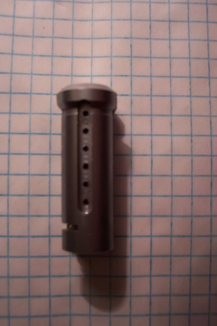

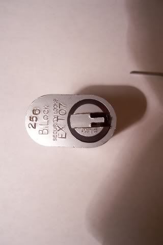

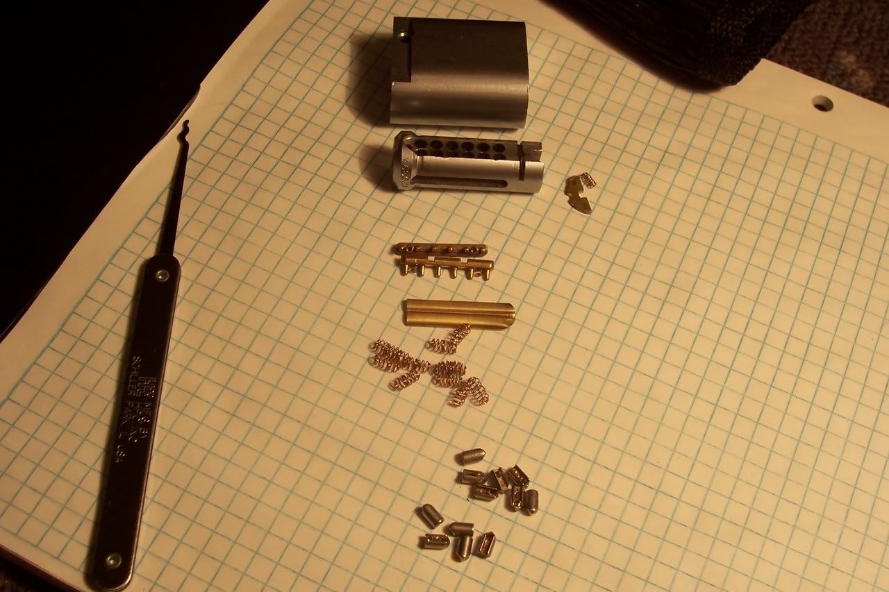

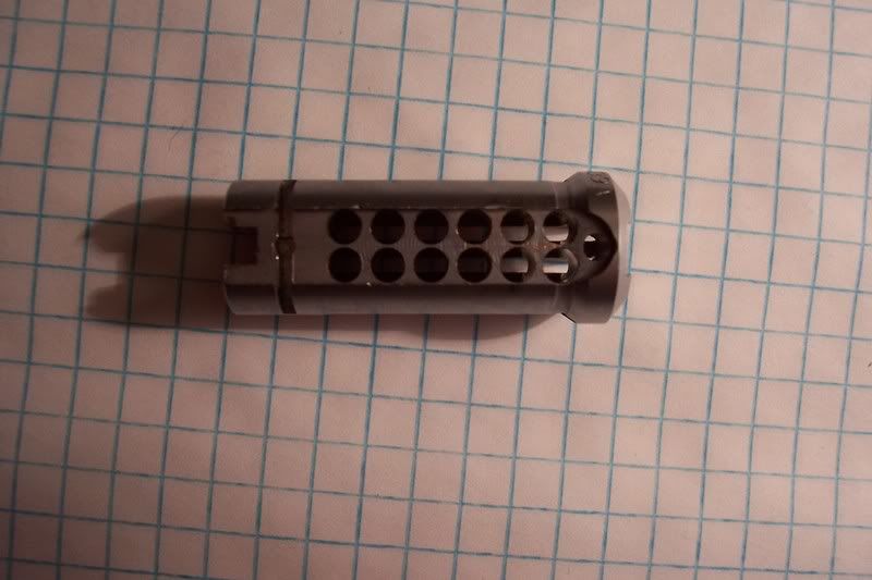

BiLock:
We have these everywhere, you pay next to nothing for a lock that is drill resistand and certainly has an aspect of pick resistance. The lock uses between 8 and 12 pins (depending on the lock and its application). In order to set these pins they need to be lifted the the exact height for the sidebars (yes there are two) to set into them. There are 3 types of pin: Standard - these have false depths (under drilled holes) Dual depth master pins - These have 2 holes for master keying and no false depths. Quad depth master pins - The pins have a milled slot that allows all possible key cuts to operate the pin, under cuts and some over cuts can be used.
BiLock NG
BiLock OG
Sorry for the size, but it shows a better picture than a resized one.
Face of lock.

Side bar slot
http://img.photobucket.com/albums/v329/skold/06cc409e.jpg
Top of cylinder
http://img.photobucket.com/albums/v329/skold/000_0126.jpg
