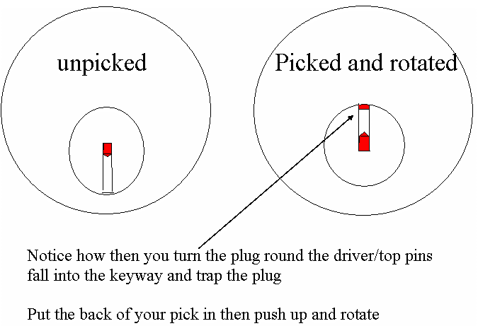

Postby chrisjc33 » 11 May 2006 1:47
here nice and easy

Postby Shrub » 11 May 2006 7:28
Just tell them not to rotate the plug 180' theres no need to, they shouldnt be picking locks they are useing and practise locks dont usually have all the hardware attached to them.
Jordy is not a bump key as that may not fit, its like a key blank but the height is uniformly below a 9 cut, basically a 4mm high blank if you will but i agree it complicates matters a bit and noobs wont have a blank laying around either but it was a good and fair point.
