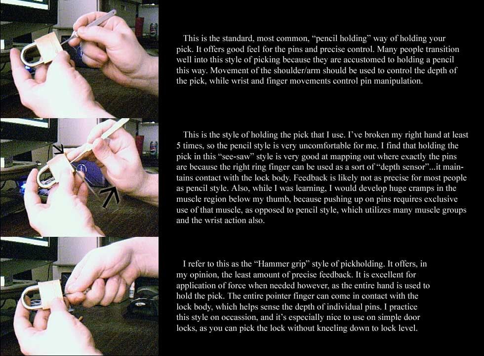

This should work.
Postby pradselost » 7 Jun 2006 20:27
If anyone knows of any others lemme know! ;D

My grip is very close to a combination of the first two grips in Prads' post. I do use the pencil grip, but I rest the very tip of my middle finger on the face of the lock for stabilization and increased sensitivity.
Works for me anyway. Truth is, there is no "proper" way. It's whatever works best for you.

Just remember that as long as you can hold the pick properly and gain the level of control that you want, you can pick however is comfortable. There was a point at which I was worried that my style of holding the pick would hold me back somehow, perhaps a decreased sensitivity to the pin setting process, but that hasn't happened...of course I"m not that great either, so maybe it just hasn't hit me yet! ;D

the finger on the plug and lock body is an important feed back where you can get it, of course, its not available on certain locks like the american with the drill resisters or the master with the outer lamination in the way, but you should be able to do the master without feedback. you can feel the plug move in relation to the cylinder body to know when you have set a pin.

I've tried the American and do find that I have a bit less "feeling" because I don't have my finger on the locking mechanism itself. *nods* The second major reason I've never gotten used to the pure "pencil grip' thing is that I feel like my hand's just kinda floating there, untethered...if at least part of my picking hand isn't touching the lock, I feel wild and out of control. =D
