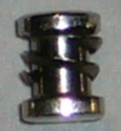

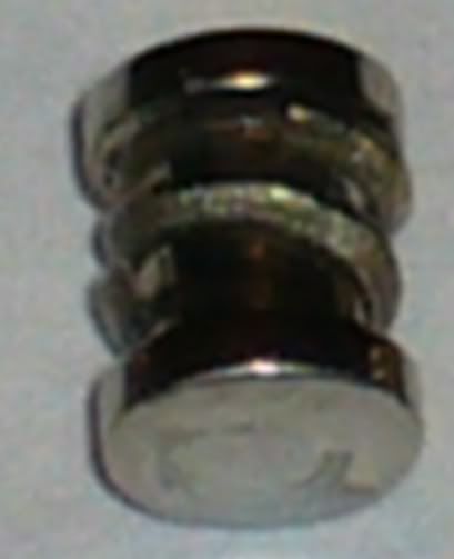

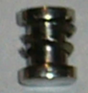

Postby p1ckf1sh » 9 Jun 2006 11:55
pinsetter wrote:They use some of the most evil spool pins I've seen to date.
Has anyone ever seen one of those spools that have a little spring wound around the thinned oart of the shaft? It looks totally awkward, I'll see if I can get a picture up of that one. I am not yet sure as to what effect the spring is supposed to have... didn't make picking too much harder when I used it in a chamber. I think I found it in an old Winkhaus cylinder.

Postby p1ckf1sh » 9 Jun 2006 16:31
Here's some pics...
