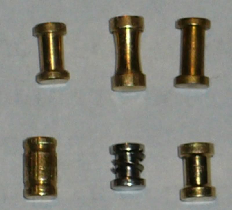

Postby p1ckf1sh » 10 Jun 2006 4:54
Here are various assorted security pins I have encountered and assimilated so far. One is a serrated (the one with two notches), the silver one has a little spring around the thin part (heck, who knows why...) and the other are regular spool type.
