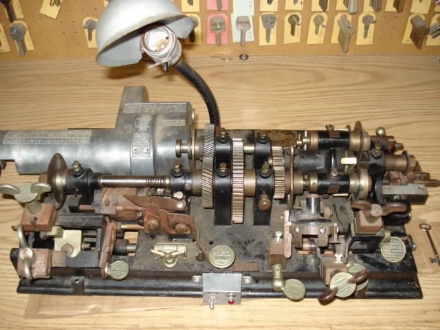

Postby I Pik U » 4 Nov 2006 22:41
Here's a couple of antique machines we scored from other locksmiths recently.
This one cuts regular keys on the left side, and skelton type keys one the right. It has 4 cutters that rotate into position on the right , 3 for different thinkness blades, and one T blade for ward cuts top abd bottom. Also a separate milling/ward cutter on the far right end.
This one is an old Yale machine, which had a hand crank set up on the pully:

Postby maxxed » 5 Nov 2006 2:57
Thanks for posting those photo's, I always enjoy looking over unique machines like those. I have seen an old Brigs and Stratton code machine that has a hand crank and another lockie has a first key machine that I would like to get.
