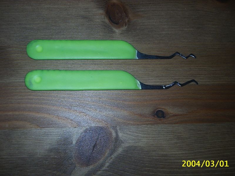

Postby scampdog » 17 Oct 2006 21:50
Here's a couple i made from 0.4mm feeler guages.
http://i39.photobucket.com/albums/e157/ ... dqueen.jpg
sorry it's so dark,my flash forgot how to work.

Postby Romstar » 17 Oct 2006 23:22
Okay, I'll break the bad news.
They are too big. Your working ends are too tall.
Romstar

Postby scampdog » 18 Oct 2006 5:15
Hi Romstar,thanks for your comments,could you tell me the best working height for the tips of these picks (cant find any on your templates), then i'll try again.

Postby Romstar » 18 Oct 2006 10:51
scampdog wrote:Hi Romstar,thanks for your comments,could you tell me the best working height for the tips of these picks (cant find any on your templates), then i'll try again.
You are right, it isn't on the templates, and its a severe failing of those particular drawings.
I am making another template of them very soon.
If you want to make a guesstimate of them yourself, take a look at a severe key with major high/low cuts and measure the distance from the top to the bottom of the cuts. Thats about the proper height. No more than a 2-9 cut if I remember correctly.
Hang out for a while, and I WILL post the new, proper templates for these things.

Postby Romstar » 18 Oct 2006 10:53
You know, it just struck me to ask if you have actually opened anything with the king and queen you made.
Even if they look too big, I would like to know if they function. After all, thats the final test.
