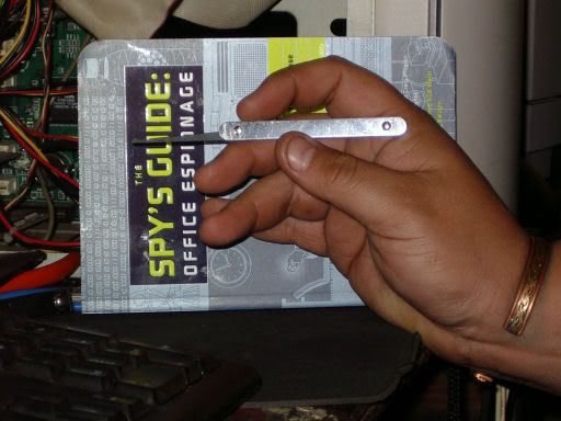

I don't mind sharing pictures. You'll have to wait for an action shot, as I don't have one at the moment.

Postby bumpit » 22 Oct 2006 3:51
I hold mine like Romstar unless I get mad I hold it in a tight fist when raking.

Postby unbreakable » 22 Oct 2006 10:36
Romstar wrote:I don't mind sharing pictures. You'll have to wait for an action shot, as I don't have one at the moment.
Romstar
You have the spys guide to office espionage!!
Its a great book, my friend has it, there's some funny stuff, and maybe even a little useful stuff in there :lol:
As for how I hold my pick, I either hold it the same as Romstar, or with it gripped inbetween my middle finger and thumb, with my index on top (kinda weird way of doing it, dunno if anyone else does the same thing....

Postby Romstar » 23 Oct 2006 15:26

Yep, I do in fact have that guide. :wink: Seriously though, a friend of mine thought it would be a good counterpoint to a lot of the other books and materials I have laying around here. Oddly enough, a great deal of the information is valid and useful. Although there are some interesting mistakes. The very first part of the book starts out with accessing rooms and cabinets. IE: getting past locks. This quote from the book:
"In the movies, trenchcoat wearing spies pick locked drawers and doors in seconds. Thats ridiculous. In reality, picking a lock can require hours of finger-numbing work, and there's no guarantee of success. A much better solution is to create a duplicate key. Since asking to borrow the original key from your boss might make him or her a tad suspicious, you should wait until you have access to the key and then make a quick impression, which can be used to make a duplicate key."
They then of course go on to describe the proceedure of maing a key impression, complete with illustrations. The technique is valid enough of course, but I found the idea that picking a lock could take "hours of finger-numbing work" quite humerous.
Obviously as a discussion on "espionage" the book deals with situations and techniques that in some instances could be considered illegal, or just on the left side of legal. In any case, while the methods are in many cases valid, they are often such that they could lead you into a compromising and potentially illegal activity. Ah, the life of the spy.......
This book, and its techniques are best left to real spies and to the fertile imaginations of fiction writers. For everyone else, it makes great reading and fantasy material. Oh if only......
Later today I will be posting some action pics of me picking a lock or two, and that may help a bit more for those people who are curious.
