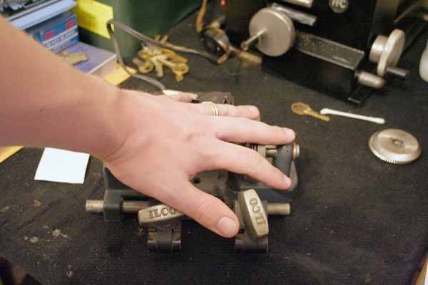

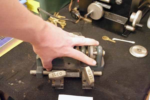

Here are a few pics of the 008 Mini mite. It is just surprising to some how small it really is and that is why I am posting pics. Some blanks such as Kwikset and schlage, mine cuts at a severe angle that you can really pick out with the eye. You can get it set up to cut keys that operate just fine, but I figure that they will wear fast over time compared to better machines on the market.
The blank is sitting on top of the motor...... The blank is an axxess 19R2 for Chrysler vehicles such as neons and dakotas (2002 era) without transponders to give you an idea of the size of the motor you are getting with the machine. In the background to the right you also see a kwikset key blank that is cut and a q-tip that gives you another size reference, albeit from a distance.
Then my hand is there for size comparison. Keep in mind that this machine weighs around 9 pounds :? .

The 008 is an ok machine for occasional use, it is small with a small motor that runs well on a small power inverter. This makes it very portable.
A local shop recently purchased a 044 and lets just say it did not preform like the older ones, so I would avoid a new one but look for and older one.

Wow, that is small. Thanks, Zeke. I didn't have any idea of the scale. I believe you have talked me into the Ilco 045. At $459 with free shipping, it won't break the budget.
