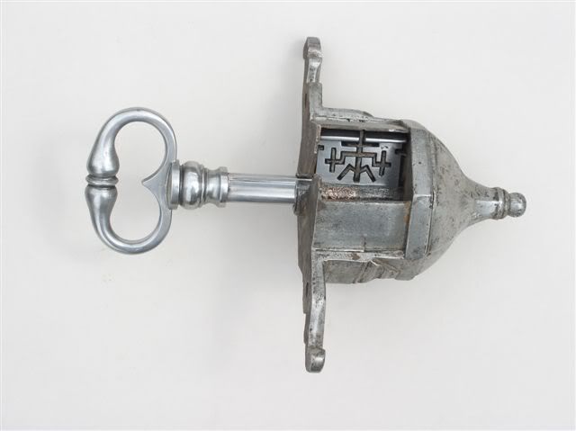

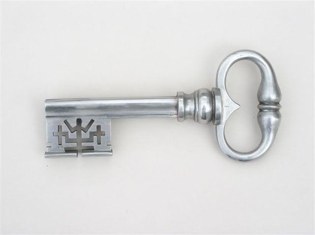

i was surching around as you do and came across this key witch i thought id never know where to start to cut one ( not that i would want to )
and i thought what a $£%&! it would be to pick but then i see a pic of the lock with the key in so ive proberbly awnsered the question anyway but out of curiosity i thought id just ask anyway lol
pix to follow

All I can say is that it is Pretty !

i dont have this lock i was just woundering would it have to be by-passed or picked ?

You wouldn't need to bypss it, it could be opened with two pieces of wire.

no idea but i would love to have that in my collection

Since you aren't asking how to bypass, I caould prvide an answer. he only real solution is to pick it and this is the simplest bypass. Unless you want to drill it, pick it.
P.S. It would suck if the delicate looking pieces of the key broke off in the lock or in your pocket. :lol:

The keys are copied or remade with a good skill on the bench with a good selection of files and metal saws, warding files may help as well for the nivce square edges,
Picking the lock would be a simple task as the way to pick warded locks is to simply 'bypass' the wards with a skeleton key or wires bent to imitate a skeleton key,
Chris Belcher sells a wareded lock impression key and bits for things like this that uses a sticky backed foil on a key blade, impression as normal,

beautiful piece. you said it's not yours, can you give any more info abotu it? age? location?
