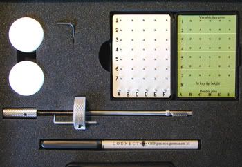

my friend has just aquired a s/h invincible make up key(sv) but we aint sure about chart , 1st colum 1to 8 levers , 2nd colum hieght lift in mm, 3rd colum says unlock allso in mm not quite sure about this last colum i allso asume an impresion is taken from the back of the levers ?..thanks in advance

Column 1: Lever number.
Column 2: Lift height - the height the lever needs to be lifted to align gate and stump. Ignore for the moment although this information is useful when you come to mix up the pins (you will) as they usually correspond to the length of the pin.
Column 3: The measurement of the impression gained from the lever bellies after taking an impression with a "P" key in the "LOCK" direction.
Cover the "P" key with plastercine (not play do) sufficiently to take the impression, but without smudging it on the lock body, and measure up from the intersection of the key stem and blade using a micrometer. Compare the measurement with the chart to determine which lever it is.
The Invinvible levers are arranged ABACD, ie Levers 1 to 5 from the bolt are arranged so that lever 1 is always the same as lever 3 (eg:53524) Once you have calculated all 5 levers, configure the pins and make-up key.
Notice there is room for 7 pins, depending on which side of the lock you are operating from place any of the longer pins to fill the spaces and act as curtain turners. I prefer to mirror the active pins ie a 53524 configuration would be pins 4253524, this is so I can use the key from both sides or cut a duplicate if needed.
This type of decoder relies on accurate measurement and the careful alignment of the pins in the make-up key. Sometimes, even with the corect combination, its necessary to jiggle the make-up key to get the lock to open.
If you dont have "P" keys, SV will supply them.

4 4 1 3
Sometimes you might feel that the measurement could be one of two possible levers, write them both down so you can swap the pins out to the next possible pin.
As you havent submitted your location I am assuming you have some knowledge of mortice lever locks and this explanation is filling in the blanks.

Bump wrote:The Invinvible levers are arranged ABACD, ie Levers 1 to 5 from the bolt are arranged so that lever 1 is always the same as lever 3 (eg:53524) Once you have calculated all 5 levers, configure the pins and make-up key.
I really meant to say levers 5 to 1 from the bolt......... levers 5 and 3 are always the same. Reverse the chart if operating from the RH side of the door.

I assumed you had a full second hand SV kit. Do you have all the pins and key reader? The key reader is the make up key and is used to read individual levers in the lock using special reading pins. Once the code has been obtained the same tool is used as a variable key to open the lock.
With the Invincible its not necessary to take impressions but it does narrow the options down.

By the way! If you have a chart that says levers 1-8 I dont think you have the Invincible as there should only be 7 lever heights I think. This decoder had a very different manner of use than the most of the other ERA decoders. How about a picture of your tool?

Da*n why cant we edit posts? Ive just been and dug my decoder out and there are 8 levers in the Invincible......so confusing ERA's.

bump. the one ive been playing about with has got 2 milled out blanks for plastercene (left&right) the actual makeup key & pins 1 to 8, oh and a small tub of plaserscene. it isnt the same as yours i beleive this is there earlier model 1996 ish...
