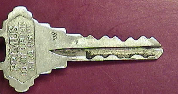

I know on the tool website there was a 15 pin lock i think being bumped... only thing that comes to mind is the Schlages, although i believe there pins arnt from the top and bottom, but the do have two different sets of pin stacks...
Here is a link to a key off a schlage primus.
http://www.locksmithcharley.com/primus.jpg

I have one of these here's a pick of the key. I removed this from a customers car and he said he wasn't going to put it back on. He could not get if off with the key, it was gummed up and sticking. I told him if he was going to throw it away that I would like to have it and he gave it to me.
