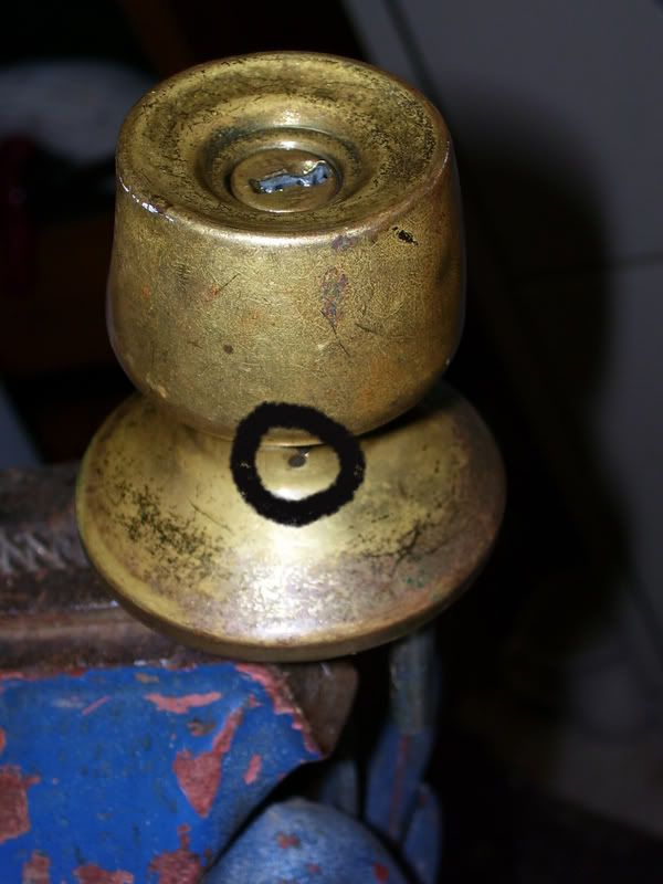

I have a lot of these door knobs laying around,,,,they look like this---->
my question is how do i get the plug out to repin the lock?? is it even possable. ?
please help for i never mess around with door knob locks....

Postby JackNco » 27 Jan 2007 17:03
pictures from the front?

Postby UWSDWF » 27 Jan 2007 17:04
JackNco wrote:pictures from the front?
+1

Postby jimmysmith » 27 Jan 2007 17:28
Yes I own a kwickset plug follower. I use it all the time with deadbolds. but when it come to this door knob lock....i am stumped on how exaclty you even get the plug loose.
the lock pictured is not a kwickset. its a yale.
how do i release the plug?

Postby cjames73 » 27 Jan 2007 17:56
is there any way to seperate the knob from the rest of handle? it doesnt look like the plug could come out of the front so you may need seperate.

Postby jimmysmith » 27 Jan 2007 18:05
I agree but how?

Postby cjames73 » 27 Jan 2007 18:45
can you insert anything into the small hole between the 2 parts?
poke something in there and see if it releases the knob.

Postby JackNco » 27 Jan 2007 19:39
i only have very limited experience but that looks like its assembled and pressed in to shape in the cheapest way possible.. there may be a way to separate it but from the looks of it not without damaging it. but i may be wrong and im sure ill be shouted down/corrected if i am

Postby lunchb0x » 27 Jan 2007 19:52
if you turn the knob and look in the hole there is a pin that can be depressed so you can pull the knob off, on some KIK you need the key to depress te pin but i dont think you will for this
if you do need te key when you turn the knob to align the pin with the hole turn the key the opposite way that you turned the knob and then push the pin in and pull the knob

Postby UWSDWF » 27 Jan 2007 20:00
put the key in turn and then try to push on the rod at the back

Postby lunchb0x » 27 Jan 2007 20:23
UWSDWF are you thinking its like the kwikset where you have to remove the spindle to tske the knob off?

Postby maxxed » 27 Jan 2007 20:35
You will need to turn the key 1/4 turn then depress the retainer in the marked hole and then pull the knob off the body of the lock
