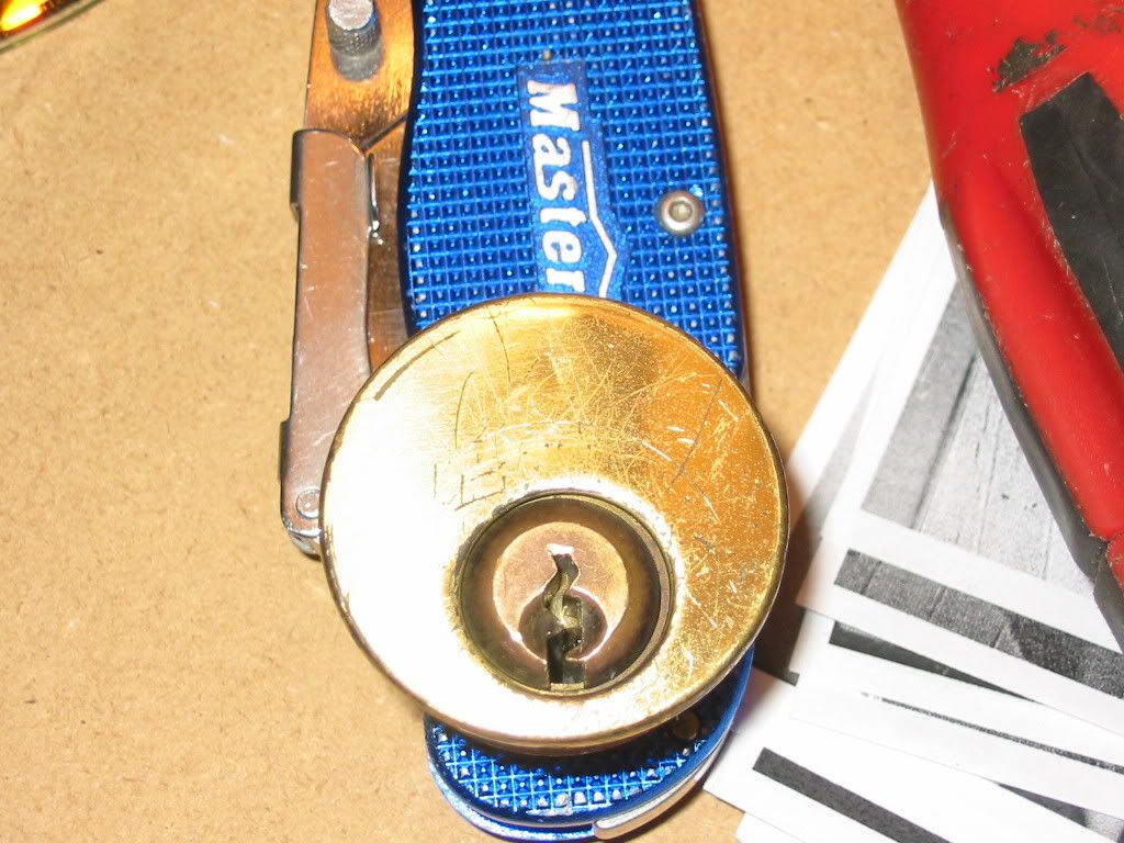

Postby NIC » 2 Apr 2007 15:17
How do i go about picking this keyway?Does anybody know what brand this is? Thanks

Postby Shrub » 2 Apr 2007 15:19
Simple lock with an easy keyway, pick it like you normally pick locks,
Not sure of the make,
Postby NIC » 2 Apr 2007 15:21
I can hardly get my pick in!!

Postby UWSDWF » 2 Apr 2007 15:25
NIC wrote:I can hardly get my pick in!!
use astro-glide err...umm...ahh slimline picks
Postby Shrub » 2 Apr 2007 15:27
Well you have to try differant picks and maybe put your wrench at the top of the keyway,
Normally angleing the picks as you go in works well as well,
That is simular to what we call a normal keyway over here, you may have to gring a pick into a slim line to do it,
Postby cjames73 » 2 Apr 2007 15:40
not sure of the brand but it doesn't look too bad.
try to follow the profile of the keyway with your pick.

Postby NIC » 2 Apr 2007 15:43
Thanks guys!!!
I guess i'll have to grind my pick,seems to be to wide !!

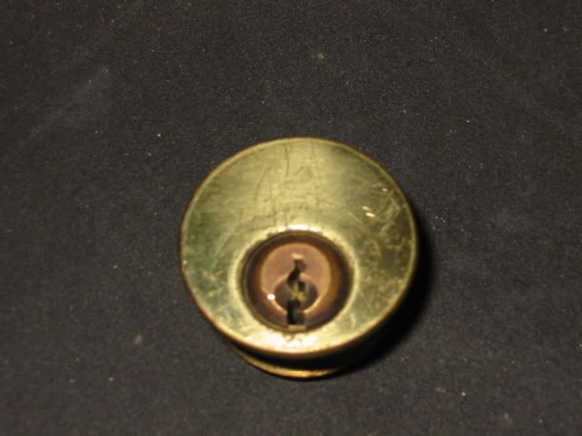

Postby NIC » 2 Apr 2007 15:59
Maybe you can see it better here ! Maybe it's easy for most of you, but if find it pretty crooked

Postby Chucklz » 2 Apr 2007 16:17
Looks like a Yale keyway to me.
http://www.jetkeys.com/yale1.htm

Postby cjames73 » 2 Apr 2007 16:22
thats very typical of a european/british lock.
once you have a slimline pick you'll find it a lot easier getting around that warding :)

Unknown Keyway: Solved! Lockwood
Postby David_Parker » 2 Apr 2007 17:55
Incorrect on the Yale I think, my guess is that its a Lockwood, specifically a H1004A found http://www.kaba-ilco.com/key_systems/pdf/Key_Blank_Directory_catalog_60_2004_NA_Cylinder_2.pdf%20%20here
Photos and process soon to come.
-Dave.

Postby JackNco » 2 Apr 2007 18:08
No idea on brand but i agree with the top tension suggestions.
I deal with locks like this with a cut down SO Twist flex. sorry about how blurry it is, its the only pick i have to hand.
But that should fit nicely in the top, and looking at the bottom of that key way its going to slip if u don't push forward on the tensioner as well.

Postby SlingsVaqueros » 4 Apr 2007 17:55
I'll second the Lockwood (L1), or Independent (IN33 or IN35) keyway, they're the same keyway, but it should help give you a lead on manufacturer. It will also help to know what area you are in as some locks are more common in one place or another. I live in NJ and I've never seen a Weiser lock, as popular as they are...

Postby Schuyler » 4 Apr 2007 20:43
Yeah, looks like a lockwood I have. Honestly? It's not the worst thing you're going to come up against, but first time I hit one I was shocked too :P If you get into the European locks you'll see some real bastages.
