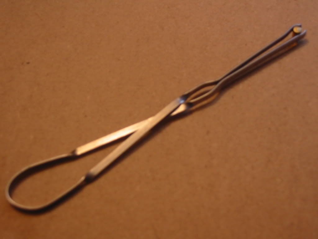

Postby NIC » 13 Apr 2007 11:17
Get yourself wiper inserts and make yourself a reverse action tweezer!!
like this.+ it doesn't cost you anything!!

Postby poky13 » 13 Apr 2007 12:14
Hy nick that was real cool. I bent a pair of twizzers, but that looks like it works better. I'm going to make one thanks

Postby 2122 » 13 Apr 2007 20:14
Thanks for the advice. I'm gonna have to try the reverse action tweezers now. I tried adding the extra arm by bending a paperclip onto the tweezers, it worked ok, but its a pain when it in the lock cause it takes up so much room. Fileing a groove into each end of the tweezer helped alot though now the pins don't slip around.
